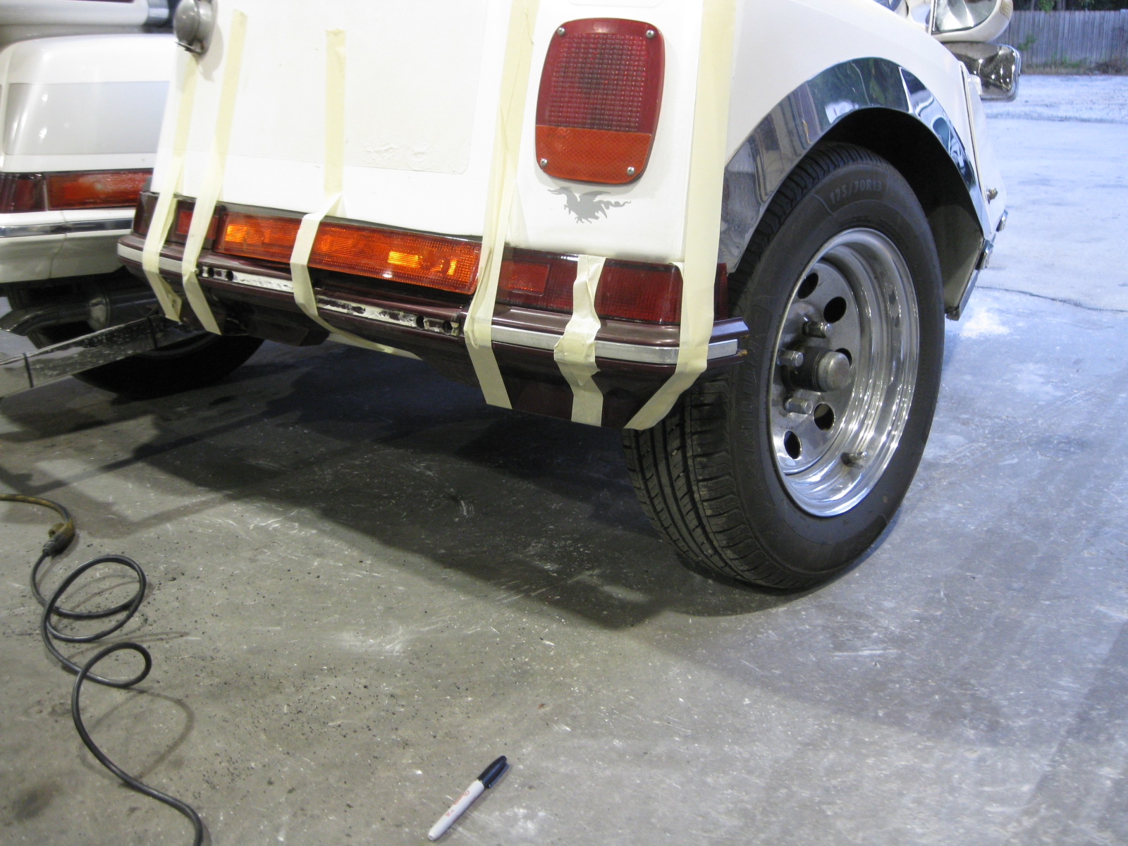

I have a 2005 Road King Custom with a California Companion GT I have finaly got it mounted. right now I have mounted a 12v car battery behind the seat and an additional 55lbs of weights rides great but still pulls to the right. I have the elect lean adjustment on some roads i have to have tire all the way up just to stop the pull on set up i had the tire all the way down is there anyone in the North Florida that anyone can recomend to help with the setup adjustment

Setup your rig with 1 degree bike leanout with you in the saddle, normal sidecar load and the suspension bottomed out.
