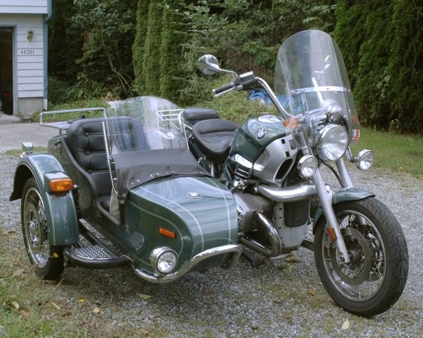

I used a front wheel from the BMW R1200C on my Ural sidecar. I need to have a spacer machined so it would fit and not slide back too far. I also mounted a disc brake caliper to fit the BMW wheel. In the attached photo you can see an unused disc on the outside of the sidecar wheel. That way I can exchange the sidecar and front wheel when on a trip and when the front tire gets a little thin.
