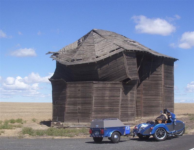

I tow a small cargo trailer with my rig. Initially I'd planned on moving the hitch to the center but didn't see an obvious way to accomplish that so left the hitch on the bike where it had always been. My cargo trailer isn't very wide and tows absolutely fine. We do leave an odd set of tracks on our dirt road however...
