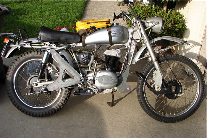

Anyway I've made some 1/4" steel plates to fit the Greeves frame and as I await the eyebolts, hiemjoint clevis and 30mm ball stud to arrive
I thought I'd post a photo and see what some of you think of my mounting scenario..... look for the four pink dots.

From looking at your photo and the pink dots I wonder about the mounting point for the upper rear strut. I've been told to create angles for strength and for that reason my upper rear is now attached to my bike behind the rear shock on the frame.

Does the lower front plate have lateral bracing?
Looks like it may need it.

Not sure about locating the upper rear behind the shock mount, thought the placement on the
1/4" boomerang would be the most rigid. We'll see..

Lonnie thanks for the advice early on, you were the first "pro" I contacted. I'm not sure how to beef up the front lower. Its 1/4" plate like the rear sistered up against the engine plates that sandwich the Greeves "I" Beam. I suppose could weld another 1/4" on the rear of it where it "flags " out to the front. Not a whole lot to work with there without bumping into the leading (trailing?) link. Any ideas would be appreciated.
The wheelbase on the Scottish is just over 50" and it weighs in at about 220lbs. I've set the 560 lower mounts up perpendicular to the bike and chassis at 26". The rise on the uppers will be 12" at the rear and 17" at the front attaching to the hole in the Greeves factory casting adjacent to the steering head.

By the way I strongly doubt about the strength of your frame and mounting plates, that it would last the sidecar's forces. My first rig was an MZ ETZ20 with the original "Superelastic" sidecar. I went a lot into the greens in flat northern Germany. It's name in stead of Jolly Roger 1 would have better been "Superplastic" or "Superplastilina", because every few thousand km I had to bend back the fist, the sidecar and back swings as well as the front fork. The forces you put on a bikes frame with a sidecar are way harder then the worst trial ride in the outback you do normally.
The Velorex has way better materials then the MZ sidecar, but isn't your bike too neat for to damage it?

I think I would put a reinforcing bar/angle on the lower section of the plate by the swing arm, all the drag on the car is going to be transmitted to that area and if it mounted by the swing arm pivot you have fulcrum point and a very large moment arm that needs to be made very stiff.

For the front I've boxed the engine plates/I beam with a plate
on both sides with a 1" schedule 80 pipe welded in between.
The stud for the 30mm ball will run thru it.
That should take care of the lateral flex problem Lonnie pointed out.
For the rear I'm working out some sort of "strongback" to prevent any
flexing that may occur on the free end of the boomerang.
Things are tight with the swingarm and brake rod quite close so the design
is still in its prototype stage.

then may I suggest that you beef up your mounts preety of a bit. From the back compasses shaped plate I would strap up to the main beam under the tank to protect the fork frame that goes to the shocks.
And possibly you will see soon that your front break will ask for a full size drum.
