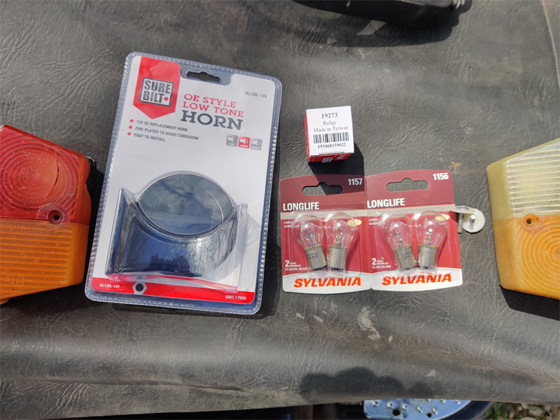

Electrical Repairs Part One:
Well, there hasn't been any "epic" troubleshooting.  Overall the condition of the electrical system seems pretty good.  Things like dielectric grease in connectors & bulb sockets and what seems like quality wire has made things pretty straight forward.  So figured to start with the easy stuff first.   Because why open the tool box when that means actual work... Aaaaack!!!!!!
Horn not operational - No horn to be operated >  Added horn
High beam not functional - High resistance through HB contact tips in relay > Replaced relay
A few burned out bulbs- Sent burned out bulbs on permanent vacation > Installed new harder working bulbs

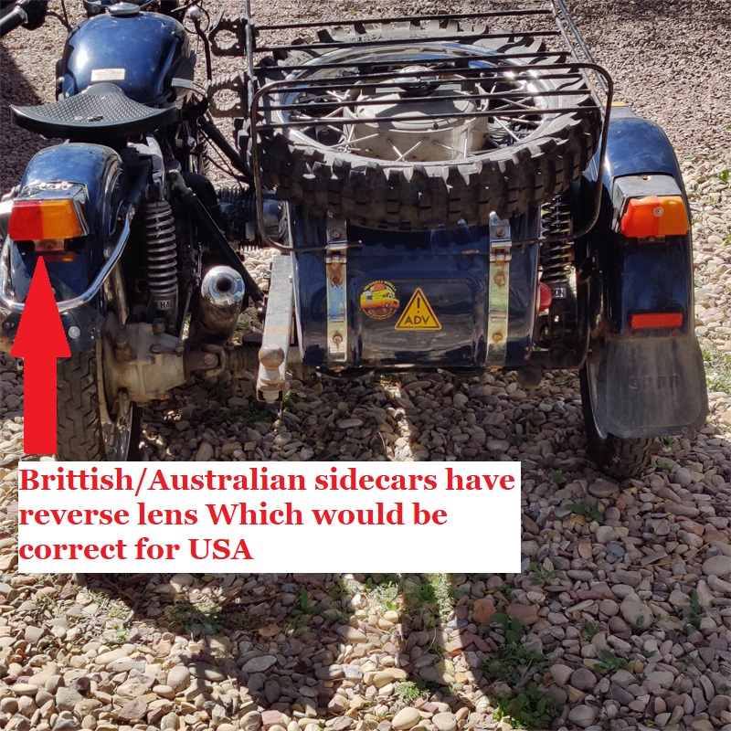

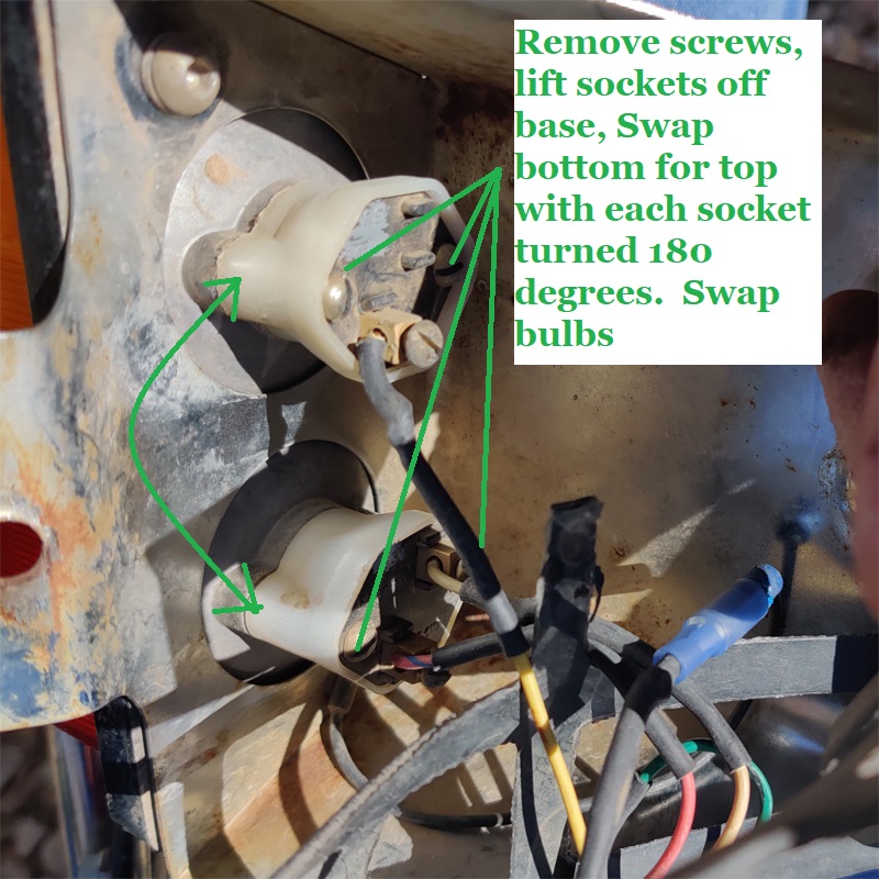

Learned a cool factoid while troubleshooting the turn signals today.  The Ural sidecar tail light can have the sockets swapped around to change the position of the Brake/Running bulb and turn signal bulb, in the lamp assembly.  Why would someone want to do this? Eliminates the turn signal lamp that sticks out on the stalk, just waiting to be ripped off by a tree or big rock.
Dana had done the swap years ago, but somewhere down the line it got changed up when the correct lens assembly broke.  When I got it there was a poor fitting black lamp base without a dual element socket (had the running light and turn signal hooked up only, no brake light).
Either I or the next owner can get the correct British/Australian sidecar lamp lens, and then just swap the sockets and bulbs around.  Then the turn signal will be to the outside of the rig in the amber lens, and the running/brake bulb will be in the red lens towards the inside of the bike.

Pictures:  * Rear lamps as currently configured.   * How to swap around the Ural Sidecar lamp socket assemblies to reverse the bulb positions to run correctly on the tugger. the dual element bulb will go in 180 degrees rotated from original to properly seat the offset pins.

Ended up installing a new horn, replacing the Headlight Relay, Flasher Relay, a few bulbs, and one fuse I "popped" while looking for a short.  Then wired in the sidecar fender light that Dana had originally put on the bike (but was removed at some point).  Since there was only a U.S. sidecar lens, I swapped the sockets for now (Brake/Running in red lens, turn in amber lens).  Cleaned and adjusted the front brake switch (it was stuck on).   Pretty straight forward stuff.
