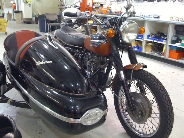

I like this. It is a 1971 Daytona. I know it is a Jawa hack made by Velorex does any one know what model it is?

The is the Jawa or Velorex 560, Much better quality frame then the new Velorex sidecars.

jaydmc - 7/26/2013 11:41 AM
Thanks if I could have seen the fender I would have know as I am still learning. I hear the 560 are hard to find and in much demand so the prices are high but if I could that would be the hack I would put on my little Triumph. Wish I could see the mounting and how they did it.
