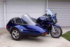

I found a picture of a later friendship model online. The windshield is almost identical. You can see it has quite a curve in it.

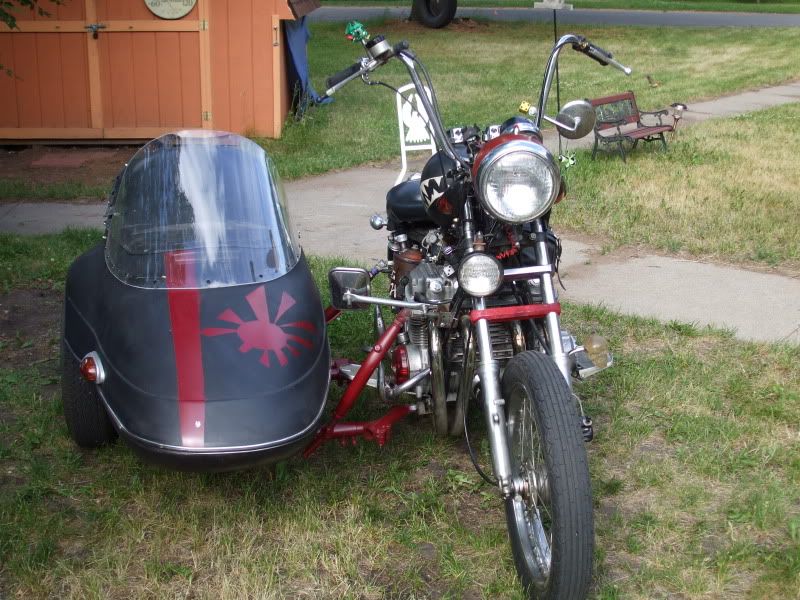

I used 1/8" polycarbonate to make a windshield for an old TLE sidecar about 15 years ago. It bent very nicely but I didn't get the scratch resistant polycarbonate. If you are careful and place a clean wet towel over it to wet down the bugs and so forth before wiping it off, it doesn't scratch unduly. I believe that the so-called "scratch proof" coating will scratch anyway.
As you point out, however, polycarbonate is now rather expensive, although if the windshield you need isn't available commercially, it may be your only choice.
