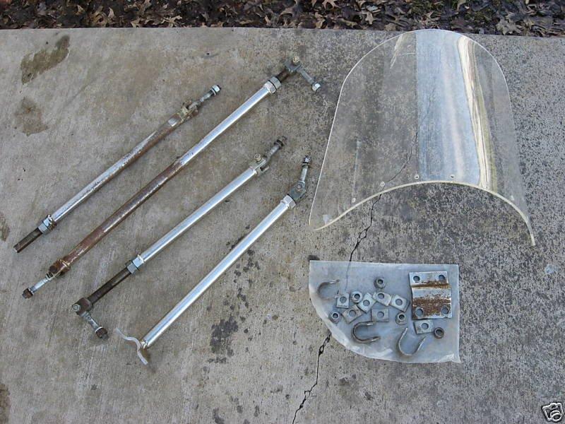

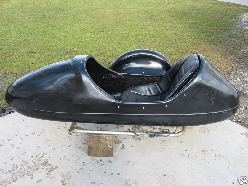

Do you have any pictures of what you do to the spirt Eagle.... I just got one and I am a total newbie to hacks... I think I have all the mounting struts but I have no idea how the hook to the Spirit eagle nor how they are supposed to be hooked to my bike... which is a 1979 yamaha 750 special
Any help would be greatly appreciated!!!

PS... I have attached a pict of the mounting stuff I have and the hack

Ernie,
Here are the positions as shown in your photo.
Top to bottom:
1- lower front mount
2- upper front strut
3- lower rear mount
4- upper rear strut
Two of these mounts used the pinch clamp on the sidecar frame. The lower front threaded into the frame sleeve. The rear upper strut (4 hole bracket) also pinched the sidecar frame.
Looks like you need the bike frame mounts. We have U-clamp assemblies that we utilize here. Much better mounting than the chintzy OEM pinch strap.
On the Yamaha XS and XJ models we use a fabricated front upper mount instead of the U-clamp assembly. On some models we also use the centerstand mounts for the lower rear sidecar mount position utilizing a fabricated sub-frame mount.
Email me off site for more information at: nwsidecar@aol.com
