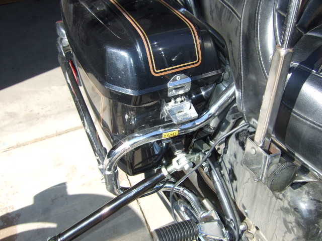

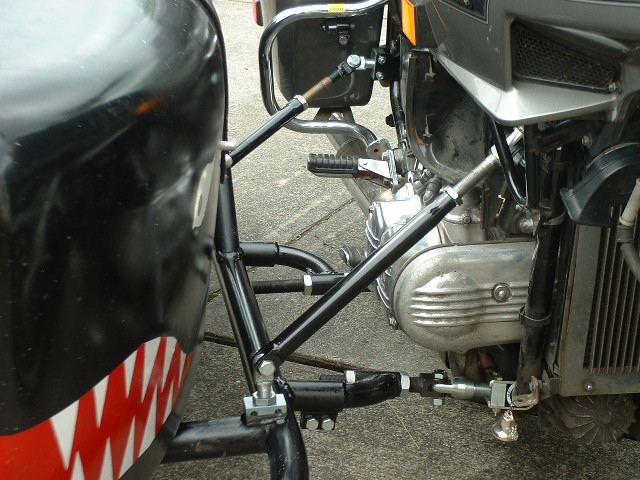

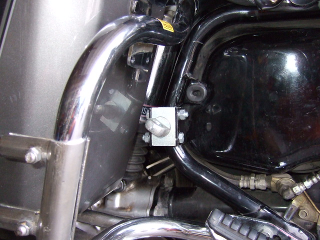

Here are three shots of '83 GL upper rear mount positions.

I just finished installing a Motorvation Formula II on my 82 Aspencade. I was able to attach the upper rear just below the point on the frame that accepts the sidecover pin. I had to modify a spare cover to finish the project. I looked at the rear crash bar and kept in mind that to mount the sidecar stout is the best way. The crash bar however appears to be very solid on the 1100's; I just did not want to take the chance. I will build an album titled 1982 Aspencade/formula II

Thank-you both for the mounting advice.I keep looking at the bike imagining a higher mounting point.I am now refocused.
I did not like seeing the crash guard mounts on the CSCs, I kinda new better,but was little shocked to see it on a big name hack.
The PICs helped alot,thanks lonnie
