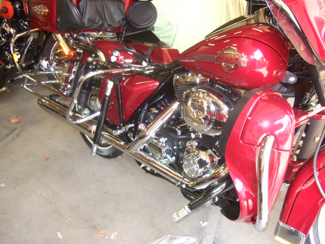

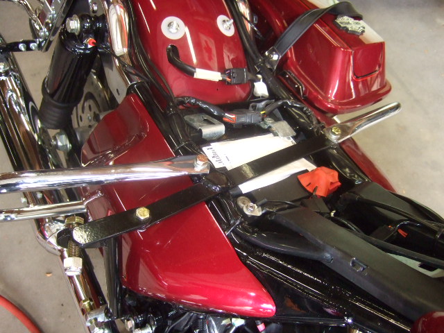

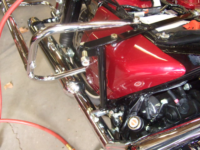

CSC made a mount that bolted to the frame behind the side cover for the '05 FLH's. Here is where it was located.
Here is Hannigans method for the rear upper mount on the FLH also.

Does anyone know where I might be able to find the mount shown in Lonnie's (Hack'n) response above? The mount is shown in the pics " '03 Peace Officers Special Edition FLHTCUI 008.jpg " above. Any help would be greatly appreciated.
