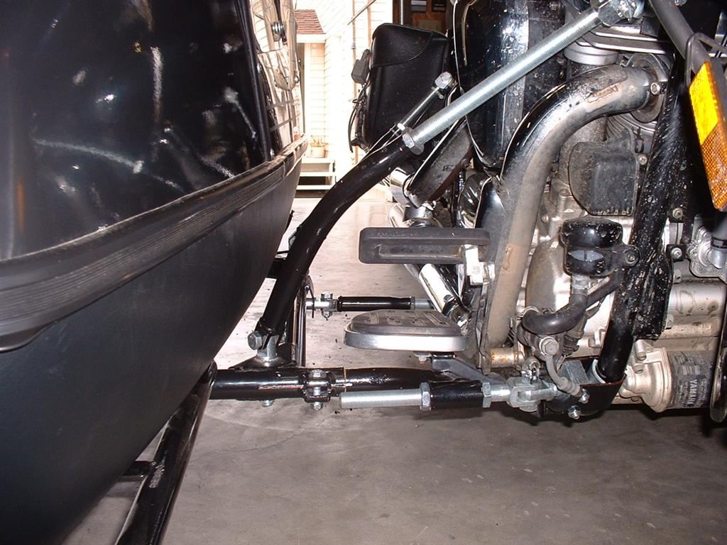

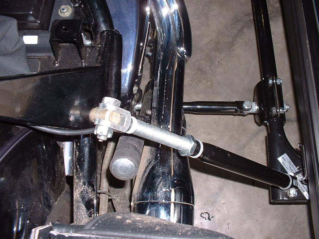

Here are a couple of shots of a '01 Road Star/Velorex 700 installation.
The same mounting positions would apply for either the Motorvation or CSC cars. The main difference being the clevis or eyebolt type lower clamp mounts.
I don't have digital shots of a Road Star/Formula II setup but for the rear upper mount it was recommended to spot weld the clamp to keep it from rotation (slipping) since it was mounted at an angle.

Hack'n thanks for the pics,i read on another site that the offset should be 8 to 10 inches, this would have to be around 22 inches for the mounts to be close to the attachment points , it appears in the pictures that the offset would be greater than the 8 to 10 inches? also was the clevis strut bent for the upper front or is this a stock part? Cycle sidecar.com has a universal mount kit, would this be the kit i need? Thanks.

I think Cycle Sidecar sells the Velorex mount kits (for use on the Cozy to motorcycle installs). The Velorex Uinversal kit is all metric sizing. It uses eyebolts on all 4 mounts like Motorvation does but there's is a 1/2" SAE sized connection. The Velorex eyebolts are 12mm which is over 7/16" and under 1/2".
The curved strut on the 700 installation is fabricated. Since then we have lengthened the strut and shortened the clevis bolt length on similar installations. CSC uses a curved strut with SAE sizing. That might work for you.
The 8" to 10" (Ideal?) mentioned is not always possible to attain due to the vast differences in bike wheelbases and sidecar wheel positioning. I try to stay within 15% of the bike's wheelbase.
Less wheel lead will allow easier steering while more lead will enhance higher speed handling.
Also less wheel lead will increase tire mileage since there is less scrubbing in the turns.
