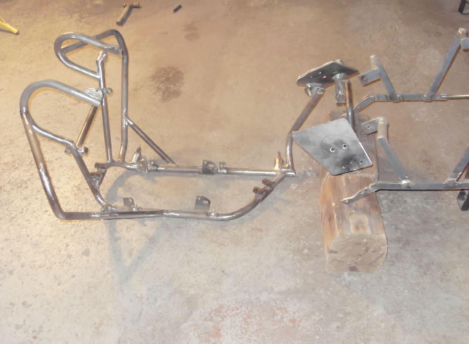

I have the bottom part of a subframe made specifically for a R1100 BMW..... it mounts to the lower motor mounting bolts and then has a seprate piece that goes up to the headstock.... I will try to post a picture of the parts I have and post them soon.

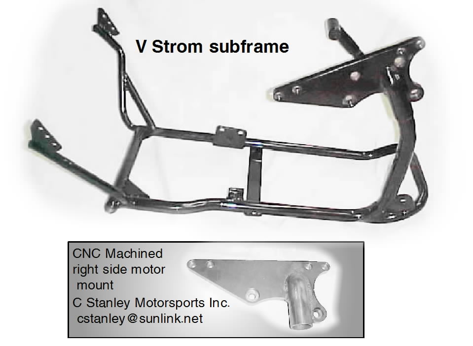

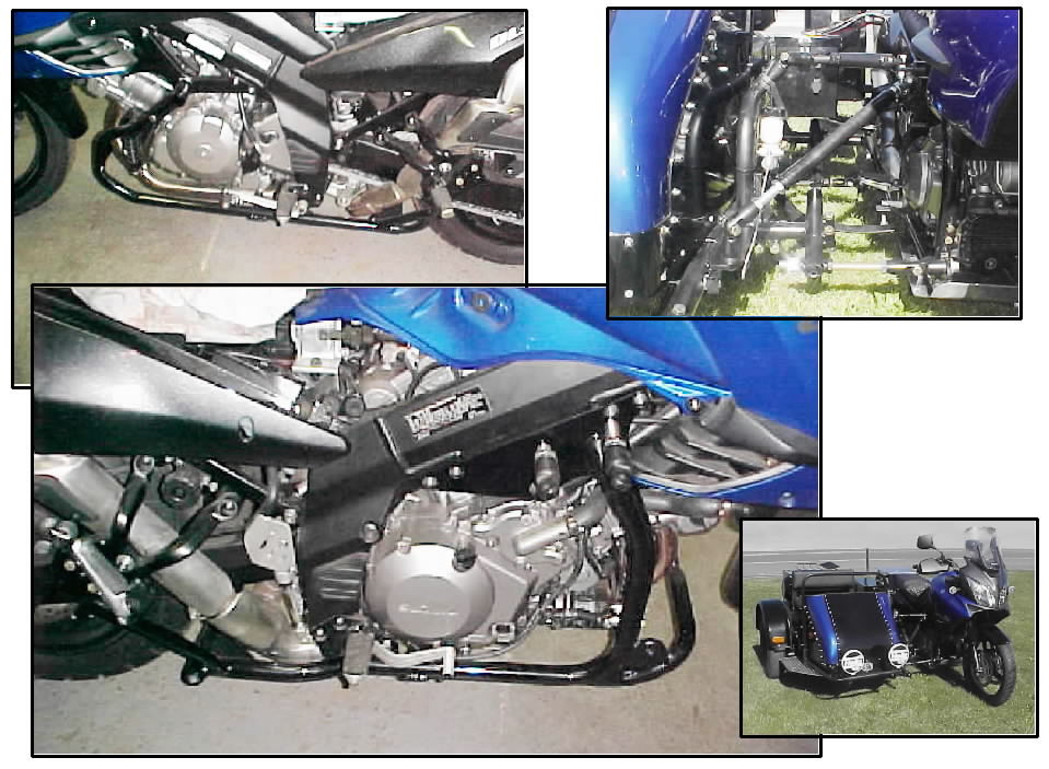

Let me see if I can post some subframe pics. These pictures are for a V Strom but it may give you the idea.
Posted : October 29, 2010 9:57 am
Here is one, in th erough, for a R1200GS. The additional stuff on the right side is for th ecustom panniers etc.

Claude,
Thanks so much for the pics. That is quite a lot of work. Nicely done, but is more than I'm willing to have someone tackle for me. Beautiful work though!!!
jack
