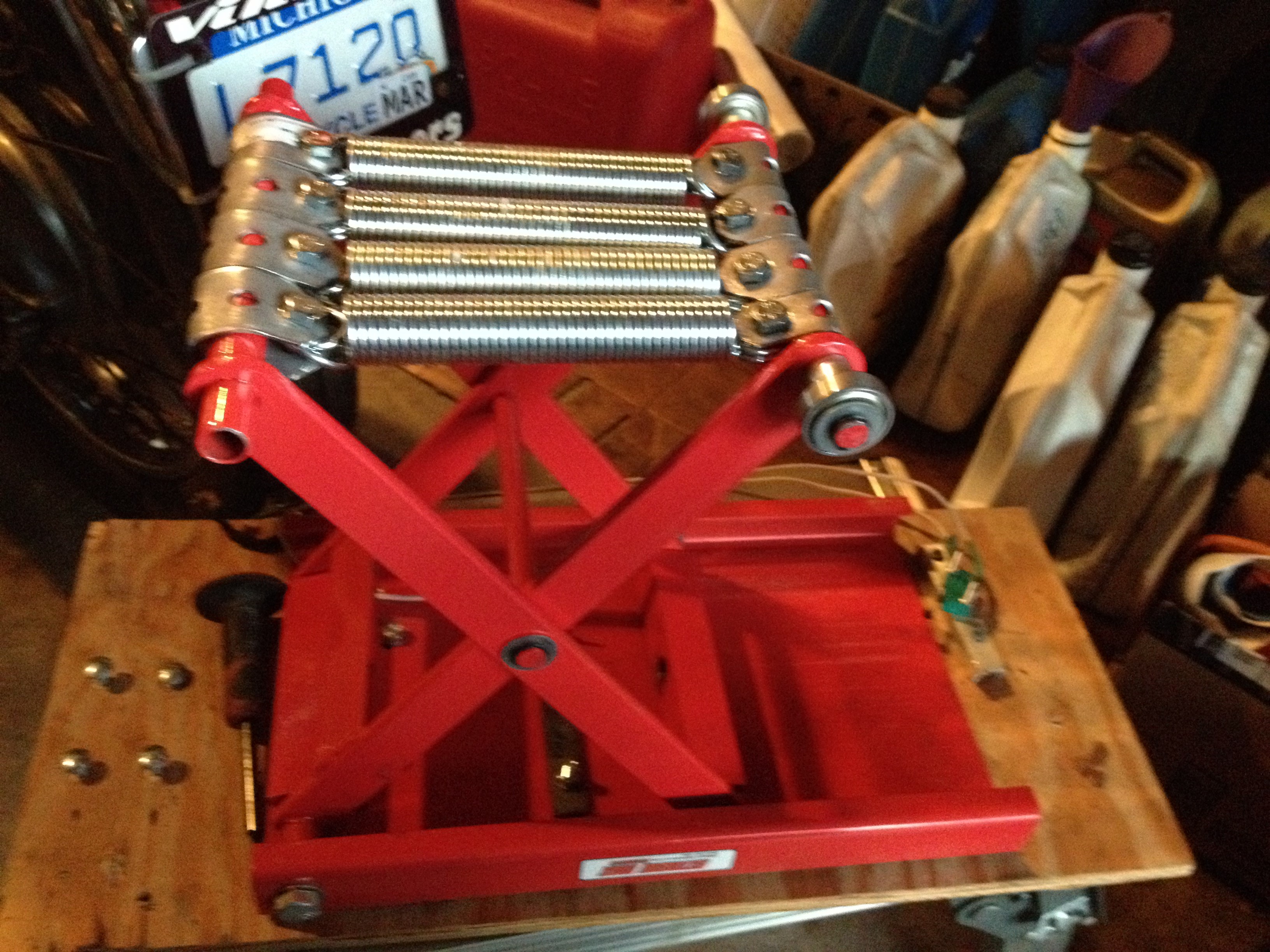

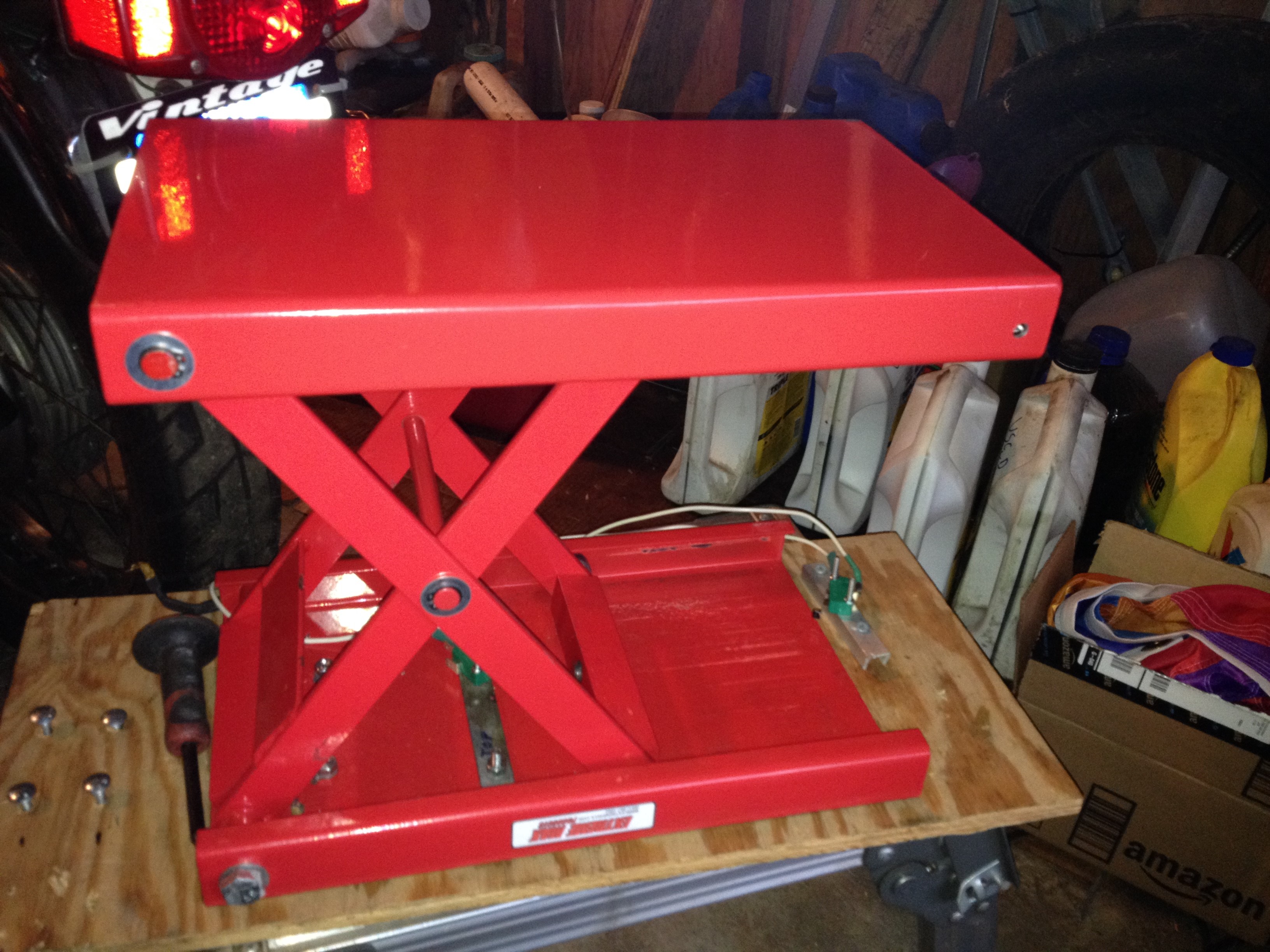

At the moment, I'm taking a different approach. All my wife really needs is help getting up to where her legs can get some bite and she can scoot herself onto the top of the trunk. Her arms aren't quite strong enough to do it on her own. So I'm tinkering with a spring loaded scissor lift to provide the needed extra thrust. Maybe this is something you might want to try before laying out the $$ to mod your tub?
The lift seat is basically a platform jack for motorcycles. I removed the main worm screw so that the scissor is free-wheeling. To add the thrust, I'm using porch swing springs under the seat. As I said, I'm tinkering with it. I need to store just enough potential energy in the springs to help her out without the added energy of a pot hole turning the thing into 007's ejector seat! Maybe a catch lever at the bottom of travel to lock it down, or a damper. I might even put the screw back in with a bi-directional electric motor so that it's a power lift seat.

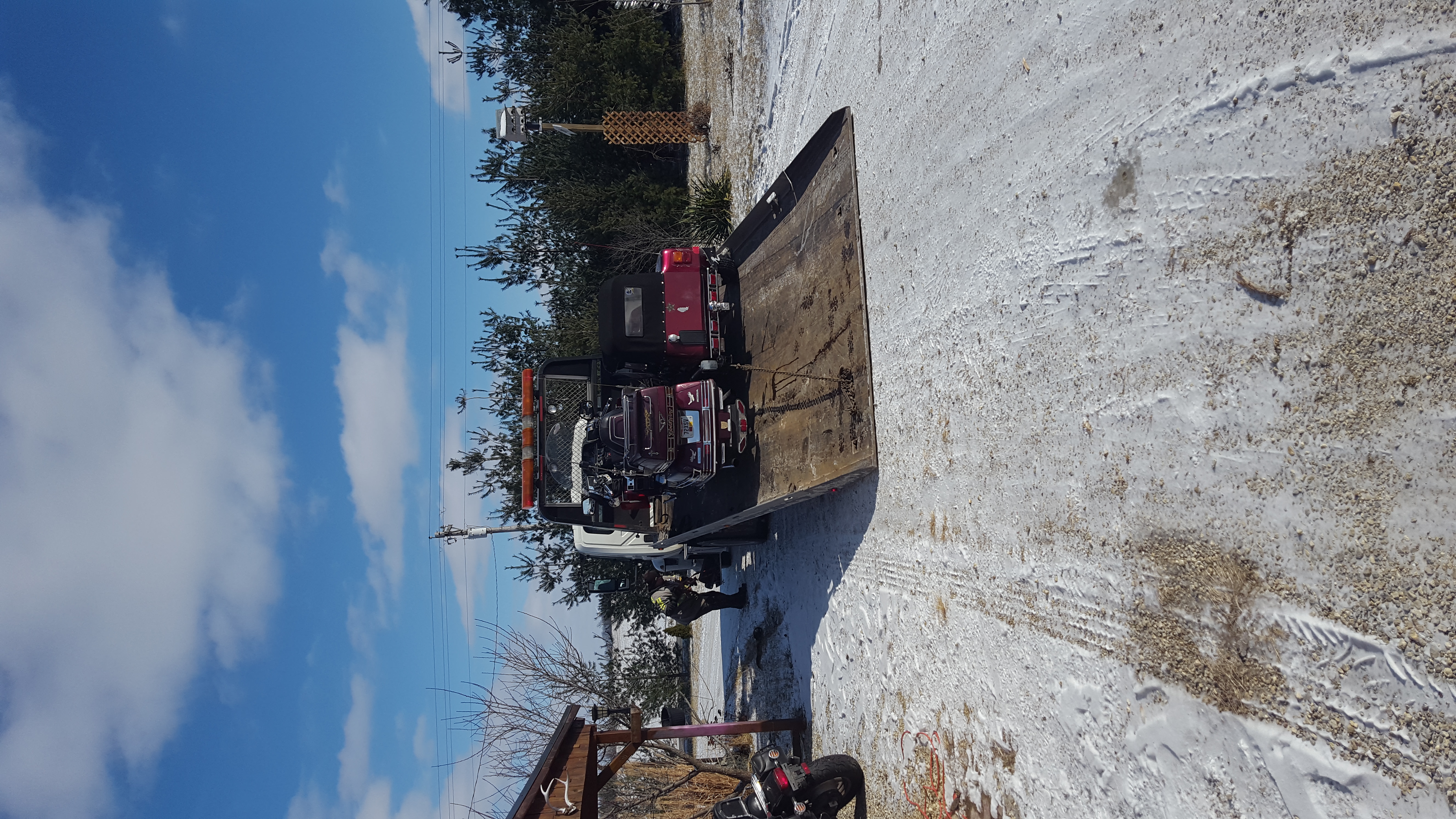

On the flatbed. Was 10 degree when we got it and the bike I traded for it

nice looking rig

Nice looking rig Medic! And I bet it was hard letting go of that Magna too. Sharp looking machines!
AJ - With all four springs, it stores enough energy that my double-wide azz can hold it down, yet it will toss me off if I rise up carelessly. I'll have to take off a spring or two for the Mrs. of course! On rise, the first few inches are less energetic than the last several. I'm sure that's due to the geometry of the scissor. I'm leaning toward the electric motor (you can see the limit switches I've been playing with) mainly because I don't want to have to add/remove springs for different riders. That and the fact that the seat height could be safely adjusted. I'm not planning for it to be a permanent fixture, rather, easily removed with a few wing nuts and bolts.

I believe that Hannigan offers an electric seat, maybe DMC has one as well. I haven't seen one but I believe that your thoughts about using an electric motor are spot on. Using a couple of the springs in combination with a motor would probably work better. The motor out of a battery powered electric drill with a reduction gear should do the trick or maybe a starter motor or a convertible top motor would be better.

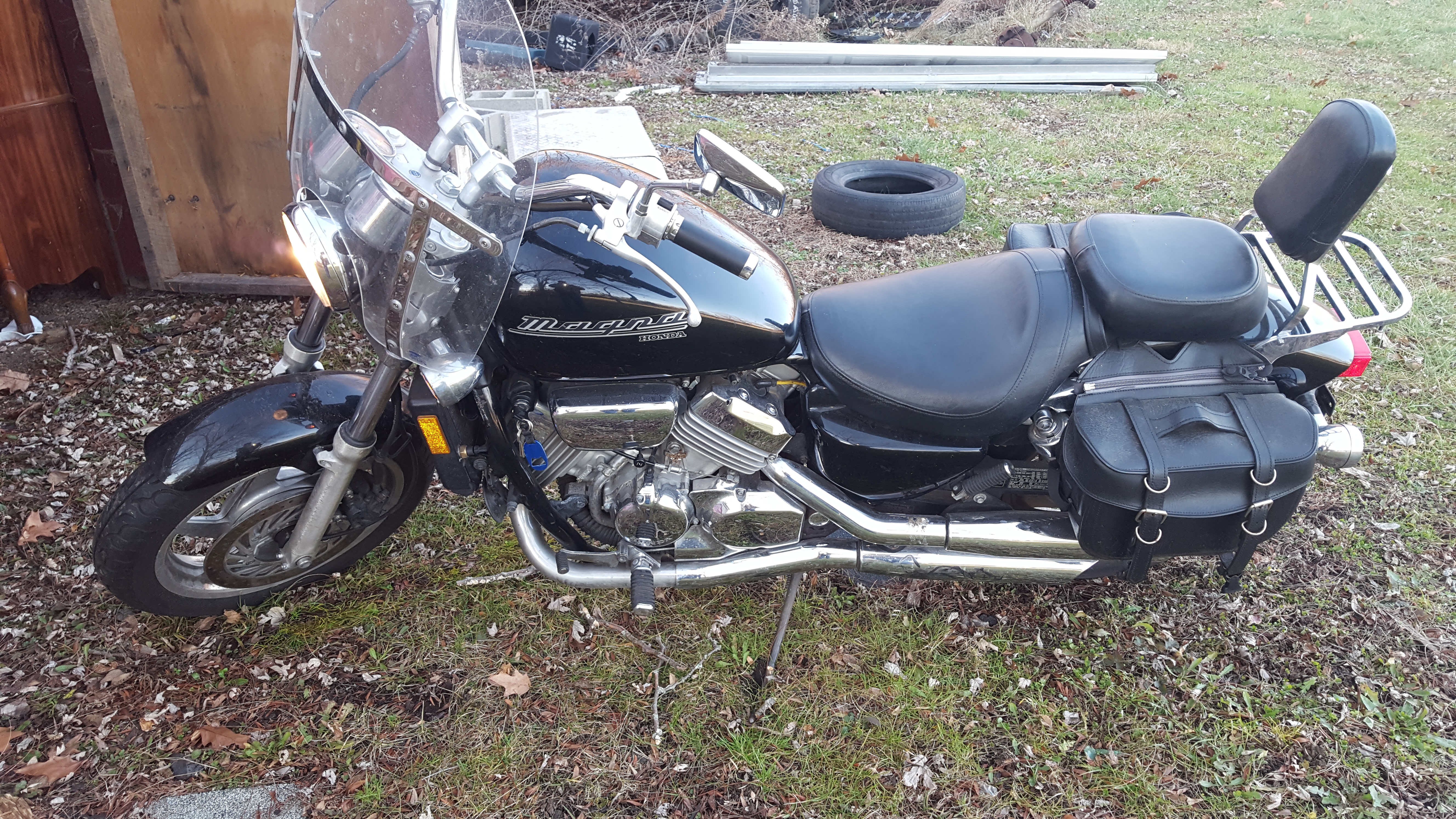

The magna was tough to let go of. My son gave to me and I got back into riding after a long hiatus. But when he saw the rig he said go for it!
