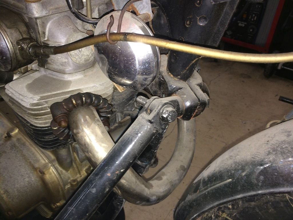

On my new to me 71 CL350 I need to adjust the lean of the bike but on the front "lean adjustment" bar I'm all the way out on the threads. Now the way that bar attaches to the front frame is with a clamp and of course I can loosen and slide it up and down. My problem is that this is the "scrambler" model and the exhaust is in the way of what looks like the ideal spot. My question is how low can I go on that front attachment before it becomes dangerous? If I drop it below the exhaust that will put it about 4 inches lower than the rear attachment.
Not sure if you can tell from the pics but if I go below the exhaust the attachment point will be significantly below where the rear attaches.
Thoughts?

Never mind. My son, who is an automotive/monster truck metal fabricator, came by and said "Lets cut that front tube and weld a heavy tube sleeve over that one extending the whole assembly about 2 inches" after measuring it. He also noted that someone had already cut that tube and welded it back together. I can only guess to fit on a previous motorcycle. No way would I attempt this myself but he does stuff like this for a living so I trust him.

Great son to have, problem solved. Good luck with the the new rig.

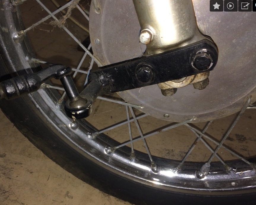

A question to post to the group is the wisdom and safety of mounting a steering stabilizer to the front axle.........???
Click on attachment below if Photo is not displayed.
Posted : January 22, 2017 10:50 pm
(@jdvorchak)
Posts: 18
It's not really mounted to the front axle. It's mounted to the front fork just above the axle. After servicing the steering stem bearings the wobble, or head shake, was eliminated. That damper is worn out, I am considering just removing it.
Posted : January 23, 2017 3:22 am
(@al-olme)
Posts: 1704
Removal is a good plan. Not every rig needs a stabilizer and a nonfunctional stabilizer is of no value.

(@jdvorchak)
Posts: 18
Al Olme - 1/23/2017 10:38 AM
I did order and receive a new damper and will install it to see if it helps with the "twitchy" feeling when riding on these rough/y secondary roads.
