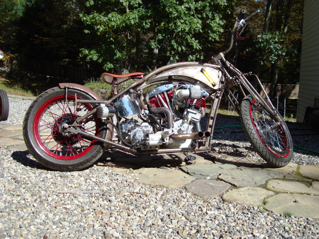

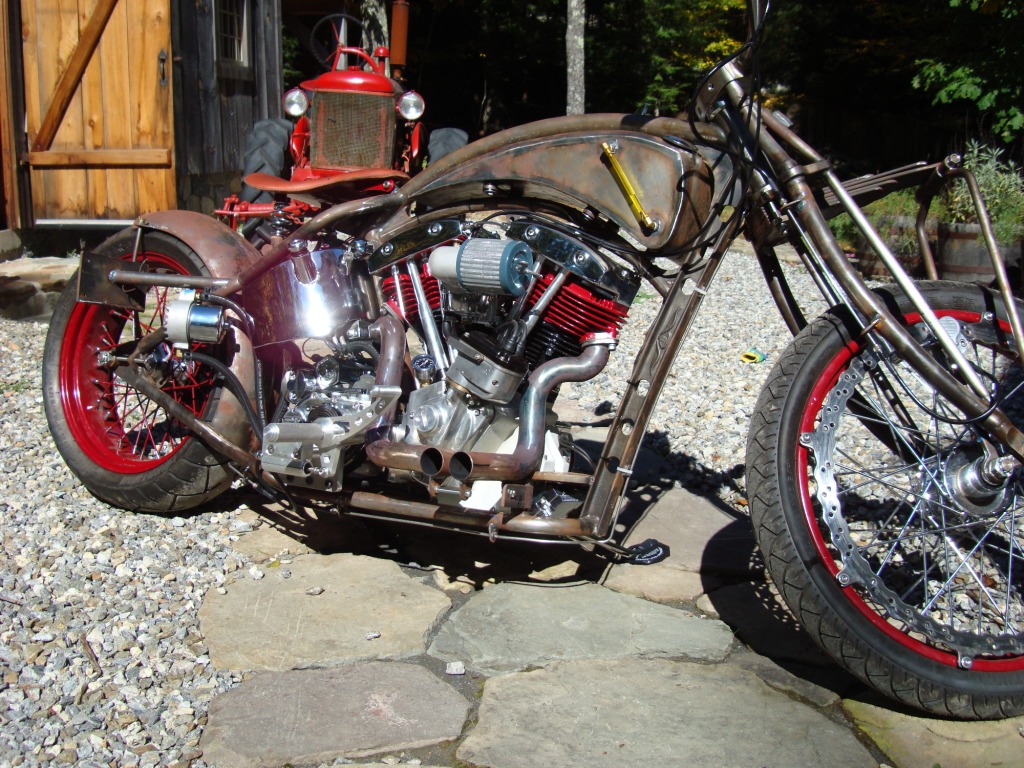

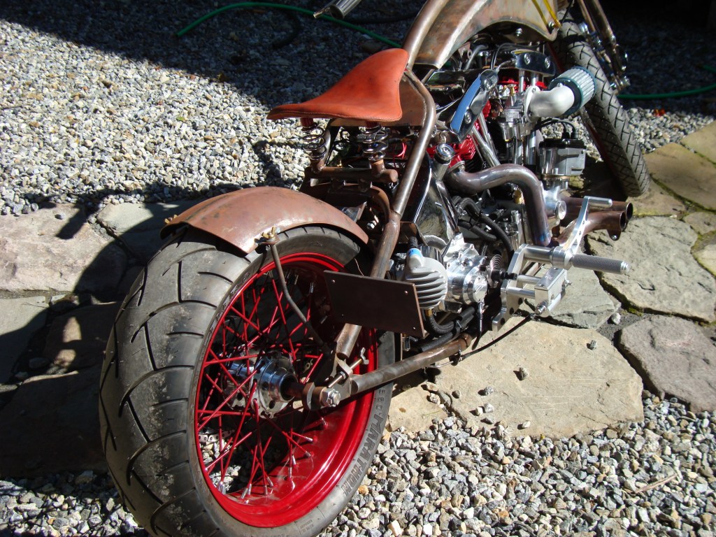

As I think through my sidecar design, I am now thinking about wheel size, and looking for advice.
Someone told me to make the same diameter as my rear wheel, which is an 18". Now I am thinking about width. The rear wheel on my bike has a 5.5" wide rim, and I have a 200mm (8") wide tire, with plenty showing, as my fender just goes to the top of the tire. I use Metzler ME880 tires, so hoping that my sidecar can be similar series. On the front I have a 21" rim, and a 90mm tire.
Any suggestions on the side car wheel and tire size would be appreciated!
Thanks
Dave
PS Attached a couple of pre-paint photos of the bike, so you can see the theme!
