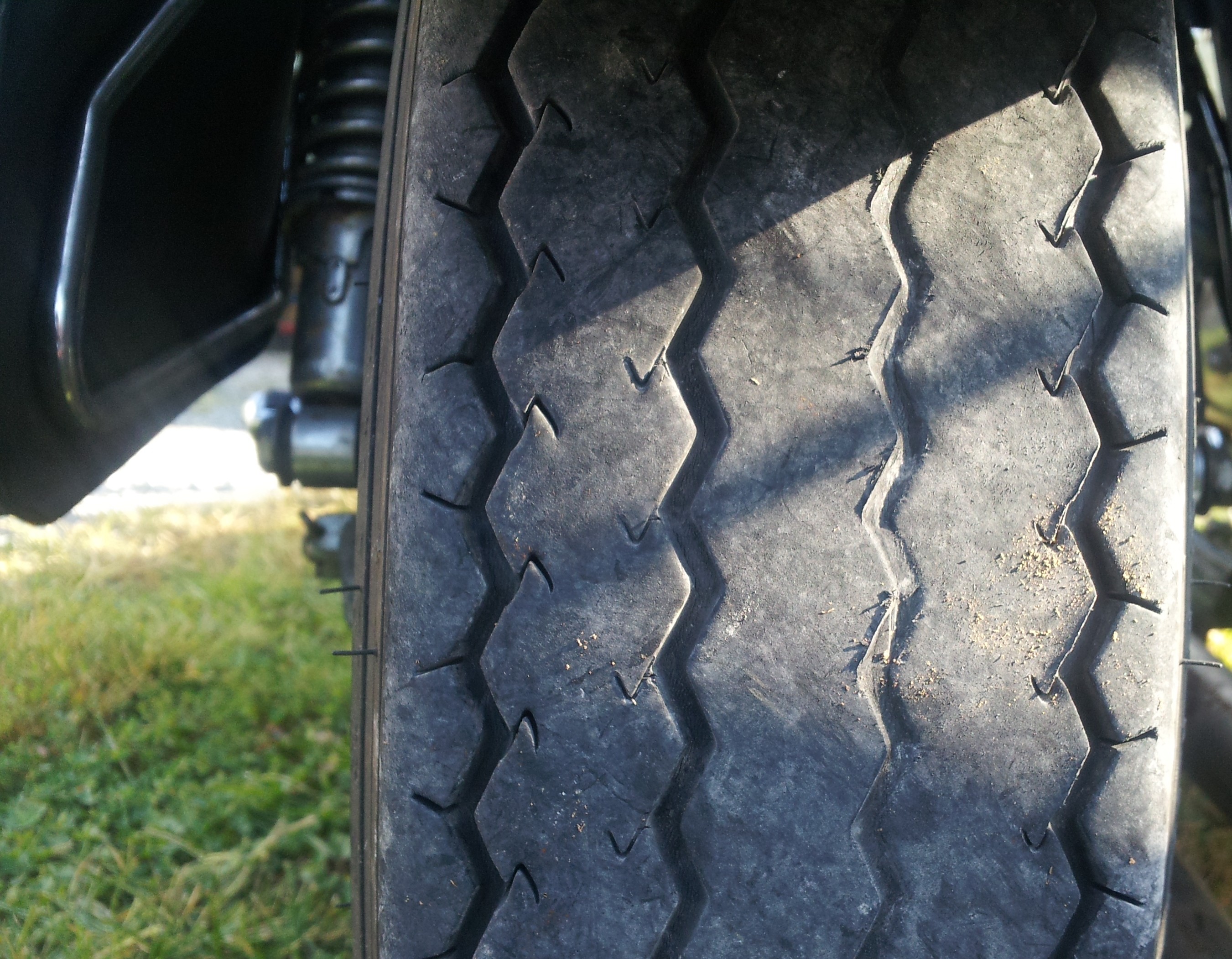

FYI I tried a Shinko 205 classic . First it was to large of a sidewall to fit my Velorex so I put it on the back of my Sporty. Installed it in March of 2012 have now gone about 4,000 miles total . The last road trip was 1,350 miles from Eastern Panhandle of WV to The Tail of the Dragon and back. we did ride the dragon twice , 28 and Cherohala Sky way. And here is what it looks like now.
