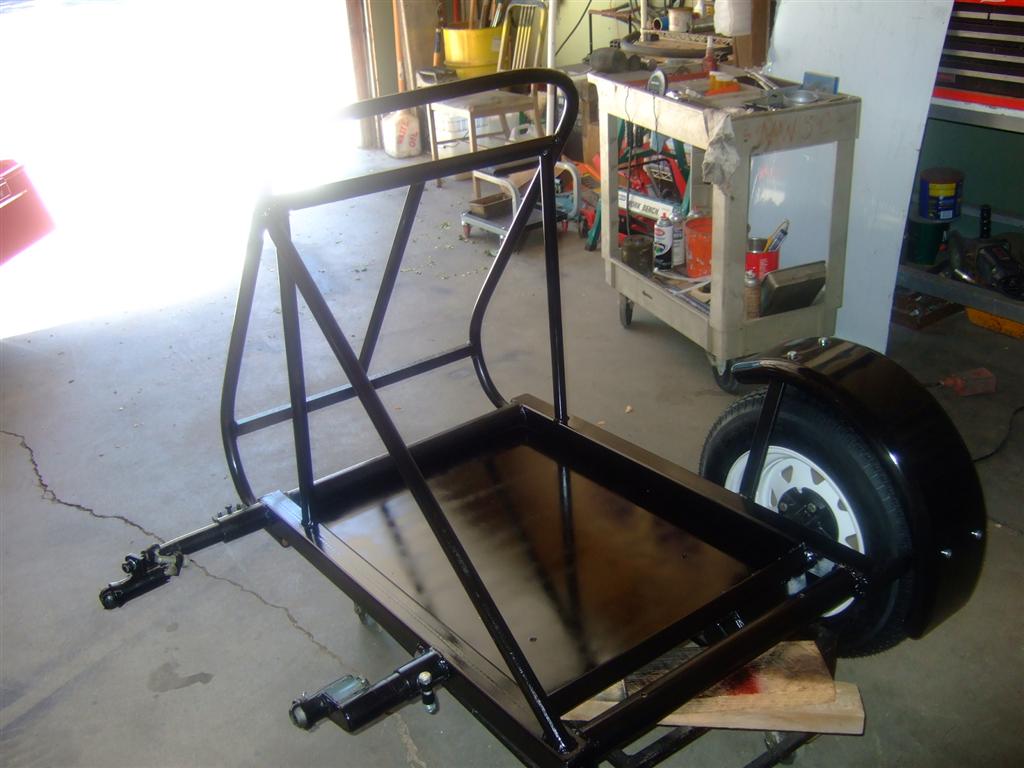

Here's a torsional suspension leading link chassis that is fairly easy to fabricate with .120" wall square tubing. It uses a 1" timken bearing axle that supports a disc brake if desired.
Posted : July 6, 2011 7:01 am

Thanks for photo, Lonnie.
Unfortunately i can't use disc brake nor hydraulic system because of law restrictions. Sidecar is treated as each other trailer. And a "lightweight trailer" must not have "active braking system". Otherwise it needs homologation, that costs more than my month salary. But Police and "Land Transport Supervision" officers don't treat drum brake with cable as active.
