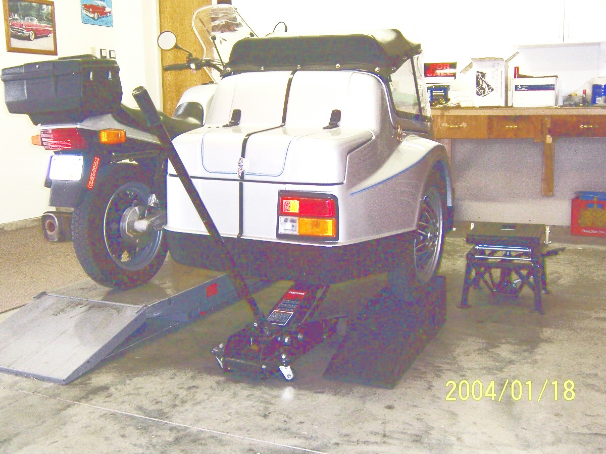

I know this is from an old thread but I didn't have my solution at the time. I have had a Handy Air Lift for 15 plus years and just needed to make it work for me. The first solution was the SO method where I had my SO put a stack of little sawhorses under the car frame as I raised the table then lifted the car by picking it up by knees and back. It took 3 repeated steps up and then down. The solution to these was a Motocross Jack I found in the Dennis Kirk catalogue for less the $200.
The procedure now is to drive the bike up on the table and the car wheel up on an oil change ramp. This is good height for a lot of things but is still not high enough to get the Motocross jack under the car frame so a floor jack is needed. It still is a 3 step process, raise the table and then the jack. But I don't have call the SO for help. The jack top is at 35 inches an the table is 28 inches
You might ask if this is a little pricey but it came in steps and is still less then a price of a set of good golf clubs ( less then$1000) and half the price of a years membership to the country club.

My SO killed my pictures while I was away from the computer so I will try again

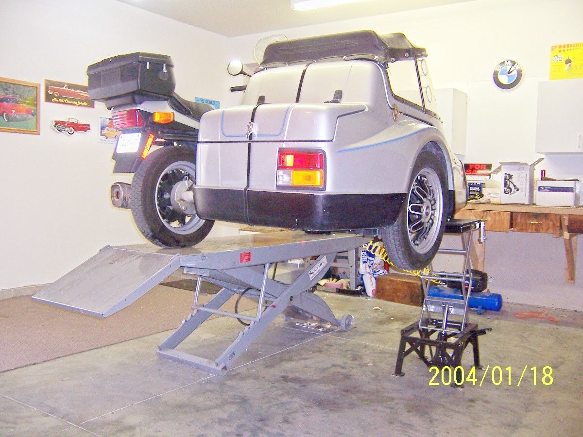

Tom: Look at the second picture. You can sit on a creeper and scoot under the car, work on the right underside of the bike and all of the suspention. The little jack is only about 16 inches square.

storage. I have the little wheel borrow wheel thingy that Handy builds so that I can move the table around the garage. except for the vice end of the table, I can park a car over it. So when not in use it really take no space at all and the little jack goes under the bench.
When I saw the motocross jack the would raise to 32 inches I saw that as my solution. I works for me. Now if I found or built a ramp with 2 more inches of rise, I would not need the floor jack. Harold
Harold
I see that on your system. Pretty good deal. I was replying to Claude in reference to building up the Handylift in either direction so you could drive the entire rig onto it. Someplace some time back I posted pictures of my rig lifted with the bike on the Handylift and the sidecar lifted with the chain hoist. It worked but wasn't worth the effort to get it there and down again. And that was in my previous shop. Haven't got the I beam in place for the trolley and chain hoist in this shop yet. Eventually...
