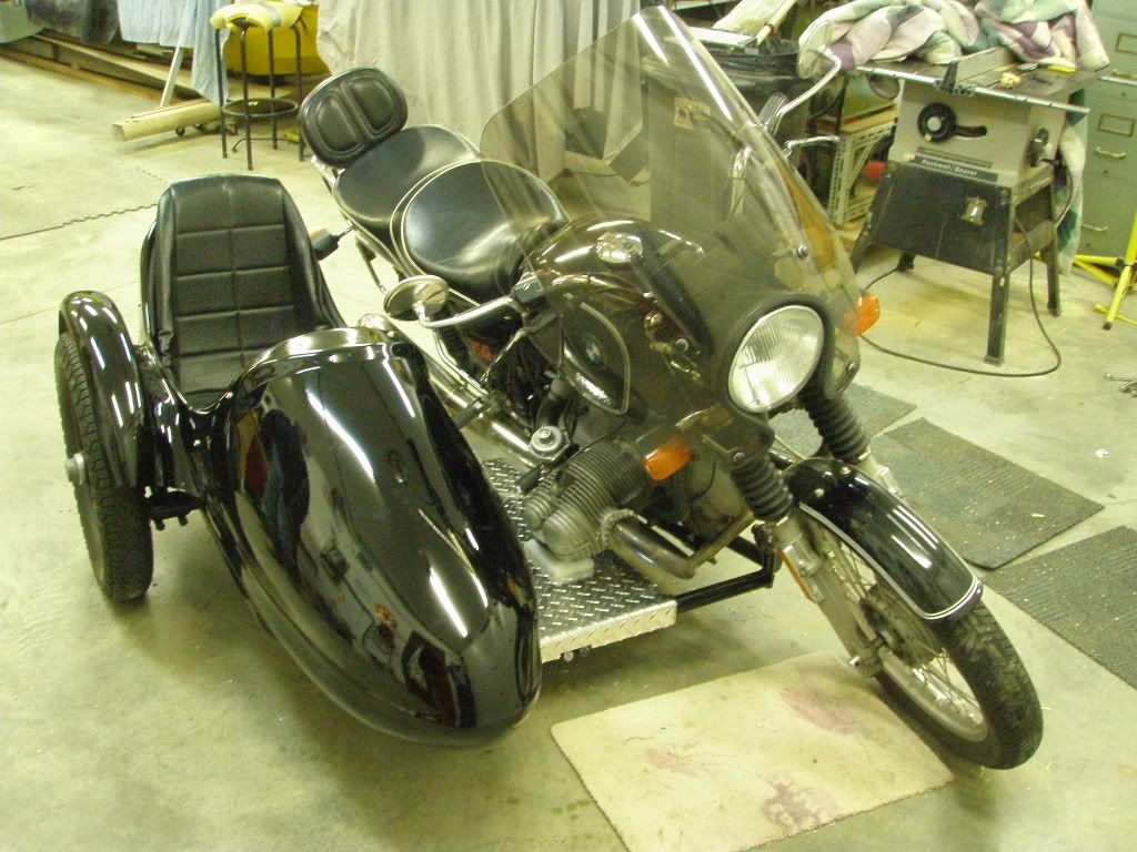

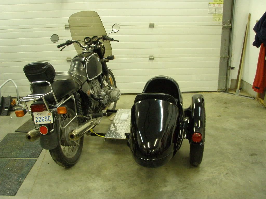

All painted and now putting it back together:

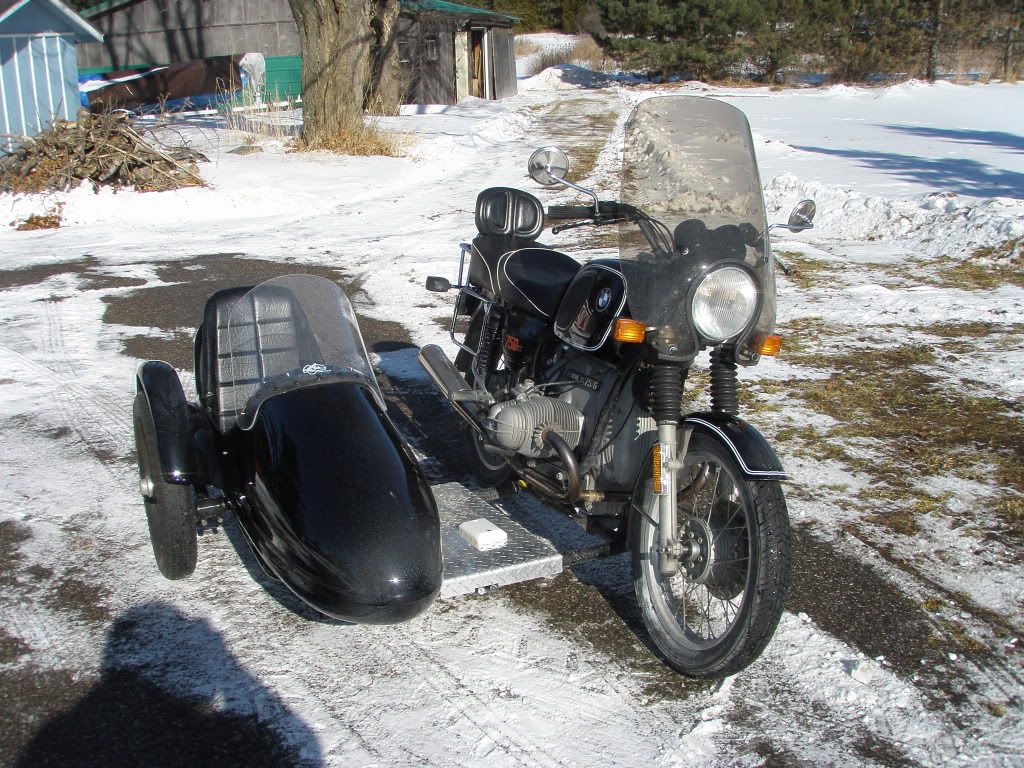

Two things based on my experience. Go easy on the right hand turns til you get a feel and know how fast/sharp a turn the rig can handle. The more lean angle the better.
I had to adjust my mounting points in order to get a nuetral steer position. Was much like yours initially but ended up moving the front pivot mount higher and outboard by about 6 inchs before finding that sweetspot. Otherwise it had a constant left lean. How is yours tracking?
Roy
Posted : January 21, 2010 10:43 am

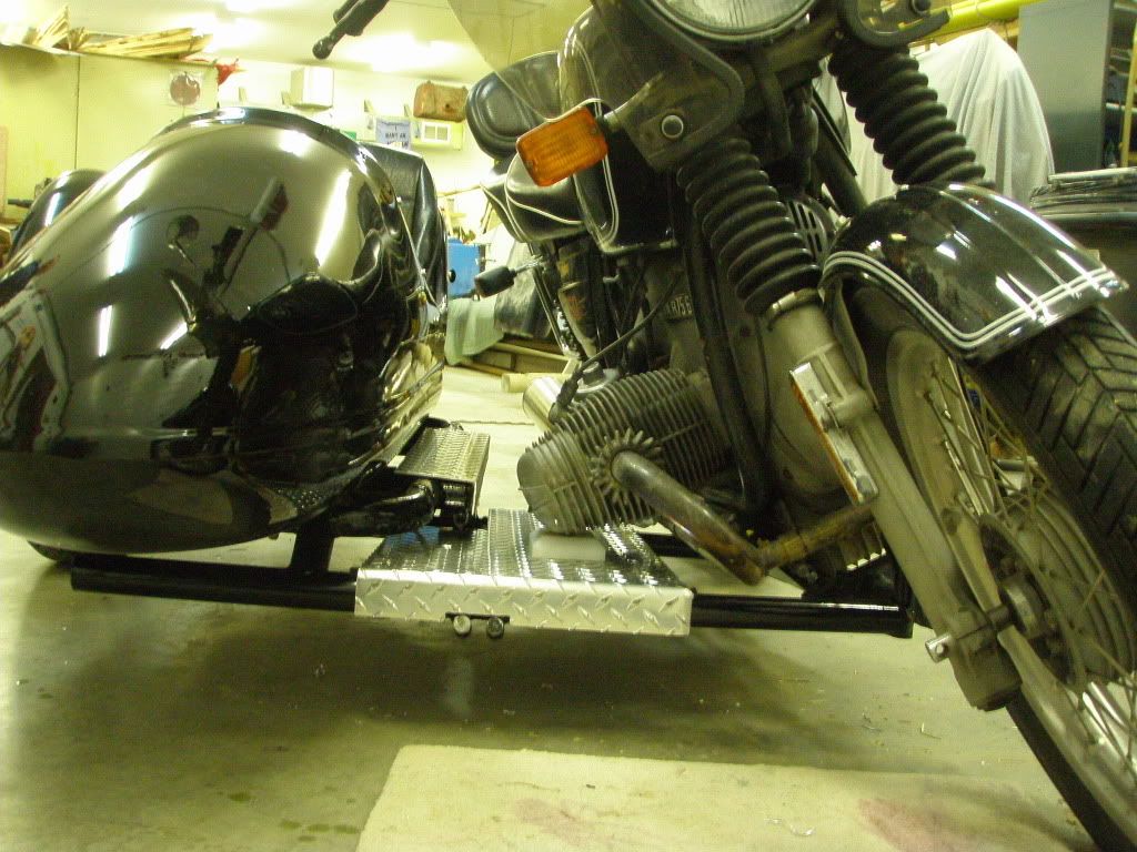

No problem with Neutral steering, Tracking is no problem either. Best part is I don't have to modify the bike other than the lower mount added.

Interesting lockout mechanism to the right.
That way you don't even need a kick stand.
Just lean to the right and park. 🙂

Before my ride yesterday, -5c and sunny.
Garry
