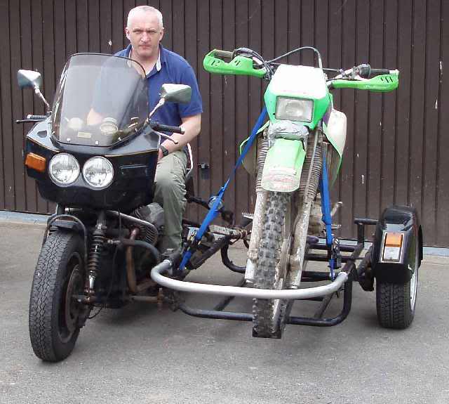

soupy1957 - 12/12/2017 12:16 PM
..........................A project of mine is to remove the tub then build a flatbed with a folding rear ramp for general hauling duties (other bikes, lawn mowers, snow blowers, etc)...........
now THAT'S gotta be quite the picture!! Let us see a pic when you are hauling another bike around!!
[/QUOTE
You mean like this?
Posted : December 27, 2017 6:33 am
