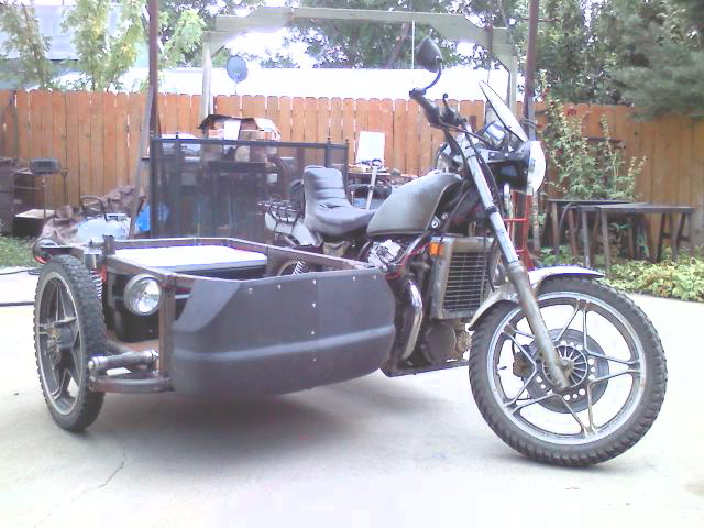

I put on a smaller tool box and a sidecar fairing/splash guard anticipating a future passenger. Thanks to Sven I am also making some beefier sidecar connections.

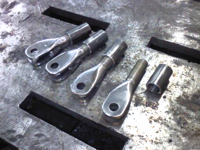

Well maybe not so easy. Real work gets in the way sometimes. Finally built some 3/4" X 16 TPI connectors to replace the originals. I'm having a problem wit my axle now. I had to anneal the steel to turn it. I've tried twice to heat treat it and it is still too soft. Wes, anybody in your area that can heat treat my axle?
