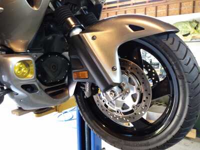

When you install a Dunlop front tire onto the front wheel of a Goldwing 1800 for use as a sidecar rig, the end result is you will get HALF the mileage out of that Dunlop tire as you can get from the proper/correct tire that should be used in this application.
Here is an example of the wrong front tire for sidecar rig use:
IMG 5219

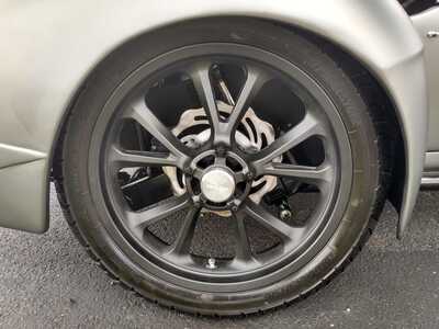

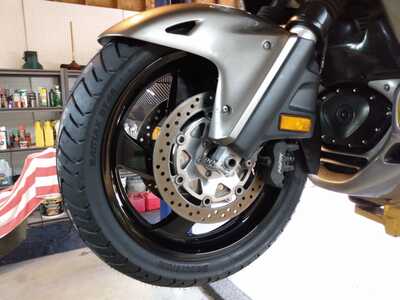

And, as we all know, opinions vary, so what one person things would work well for them, 99 other people might make a different choice.
Oddly, the other 99 people in this situation would choose the tire that has been proven to work SO well in this application, which is a Bridgestone BT-46 motorcycle REAR tire, installed onto the front wheel...backwards....and inflated to 40 psi.
009
007
Yes, those to pics above are of Thane's front wheel, thought I would post pictures he would like, whilst he is still in the medical center.
The POINT is, that it has been proven, over miles, and by sidecars and trikes, that the BEST tire to use on the front wheel of a three wheeled contraption is a BT-46 motorcycle REAR tire, mounted onto the front wheel of the bike, and installed backwards, and in doing so, you will get TWICE the mileage out of this tire as a typical motorcycle front tire, installed directionally as a front tire.

@miles-ladue First I don't know anything about the tire that you recommend mounting backwards, however I can attest to the fact that you will only get half the mileage out of the Donlop mounted front wise.  Been there and done that about 3 times on my ST1300.
