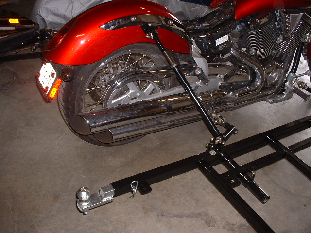

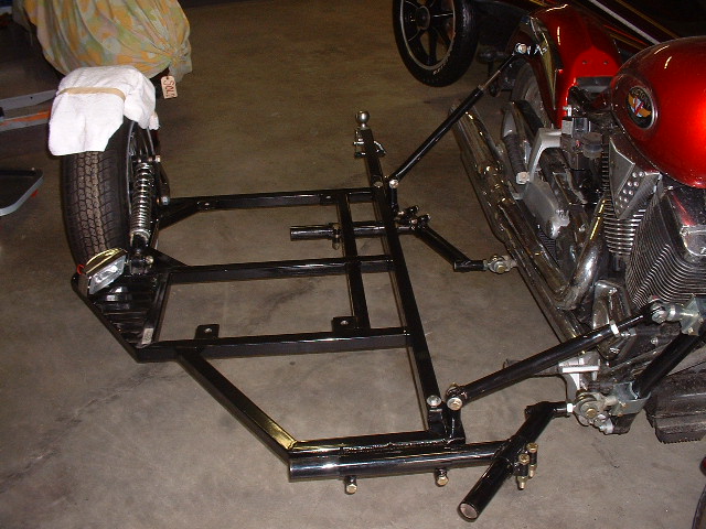

Here's a hitch I made for a pull on the inside sidecar rail.
Square tubing bolted to the sidecar frame tube.
Posted : May 31, 2009 1:29 pm

Lonnie that looks like a slick setup.
