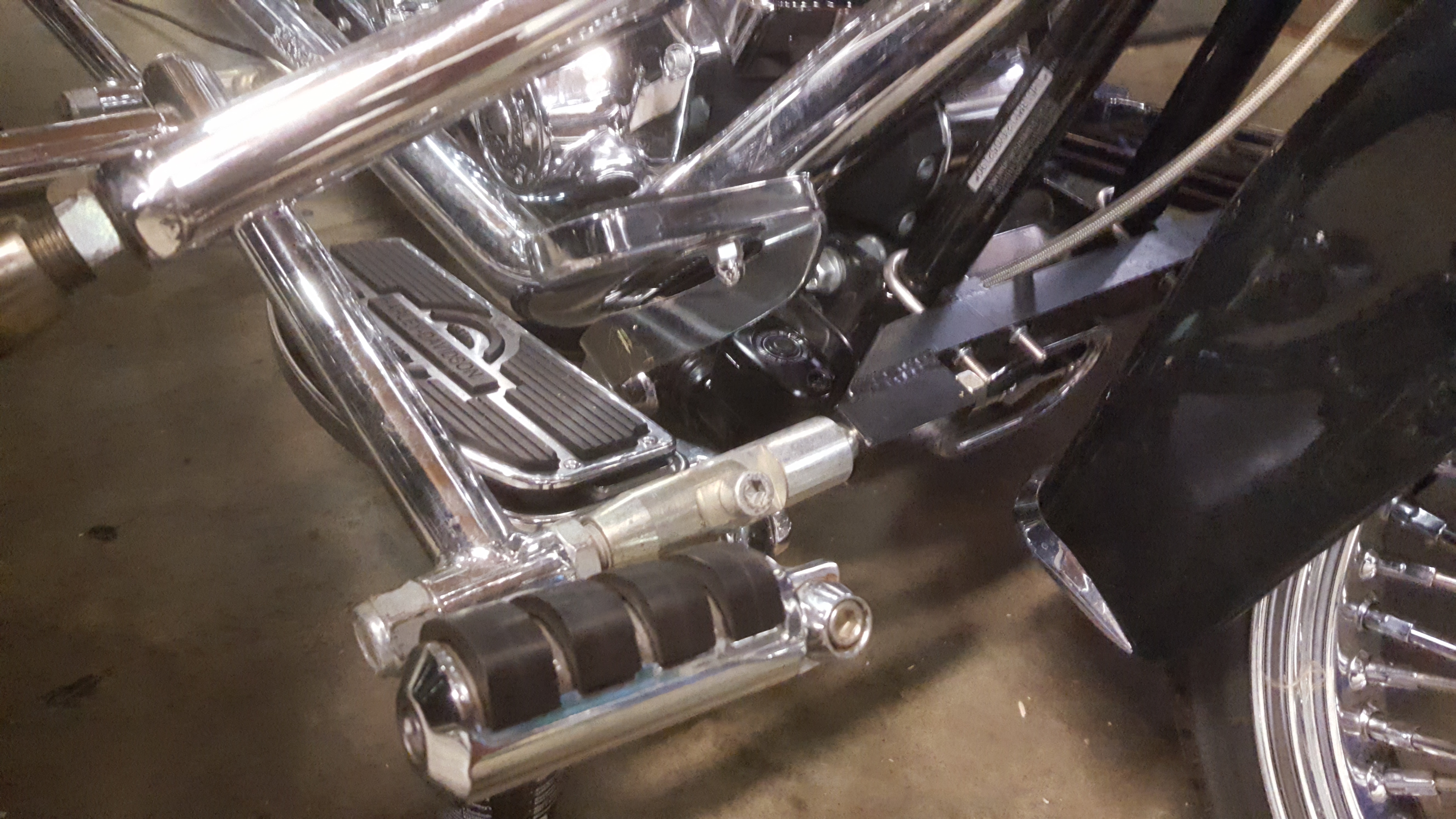

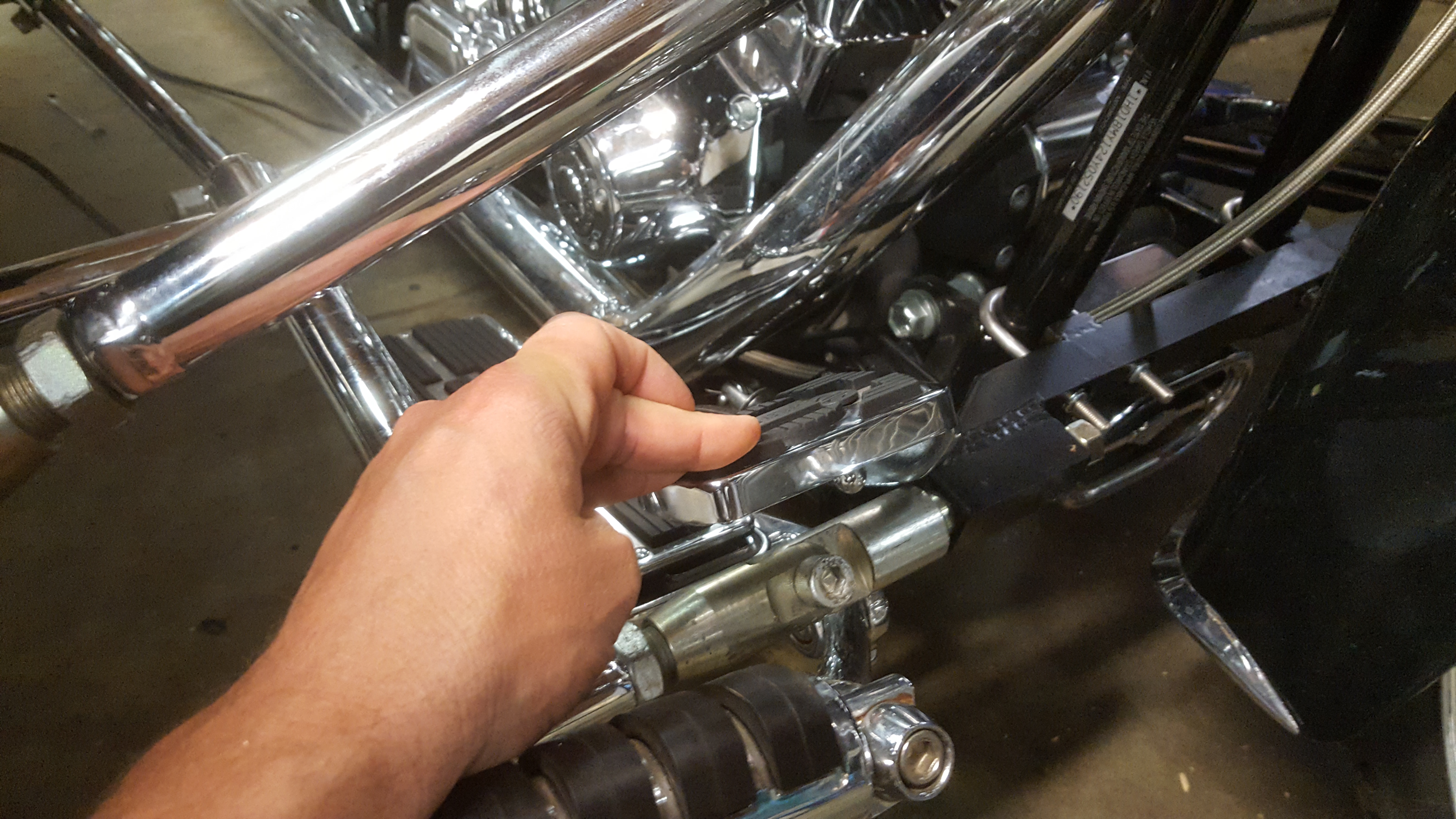

I might not be getting enough stroke in the pedal to remove the air. The motorvation bracket goes right under the pedal about 2 inches. What do u all think?

If you can't fully operate the brake, something needs to change. Even if it were working fine, if there was some problem and you needed to use the last bit of travel for an emergency stop, you're screwed. Don't fool around, move something. That's too pretty for the solution I used. I have a beater bike I got for $500, I just bent the brake pedal a little.
That can be a serious problem. You don't have much stopping you, and if you don't have a 3W brake, you absolutely rely on it.

I can get just the bike itself to bleed with the brake pedal and bracket like it is. Its when I add the sidecar that i cant get it to bleed before my pedal bottoms out on the bracket. When I bleed just the bike i cant stand on it to get it to hit the bracket.
