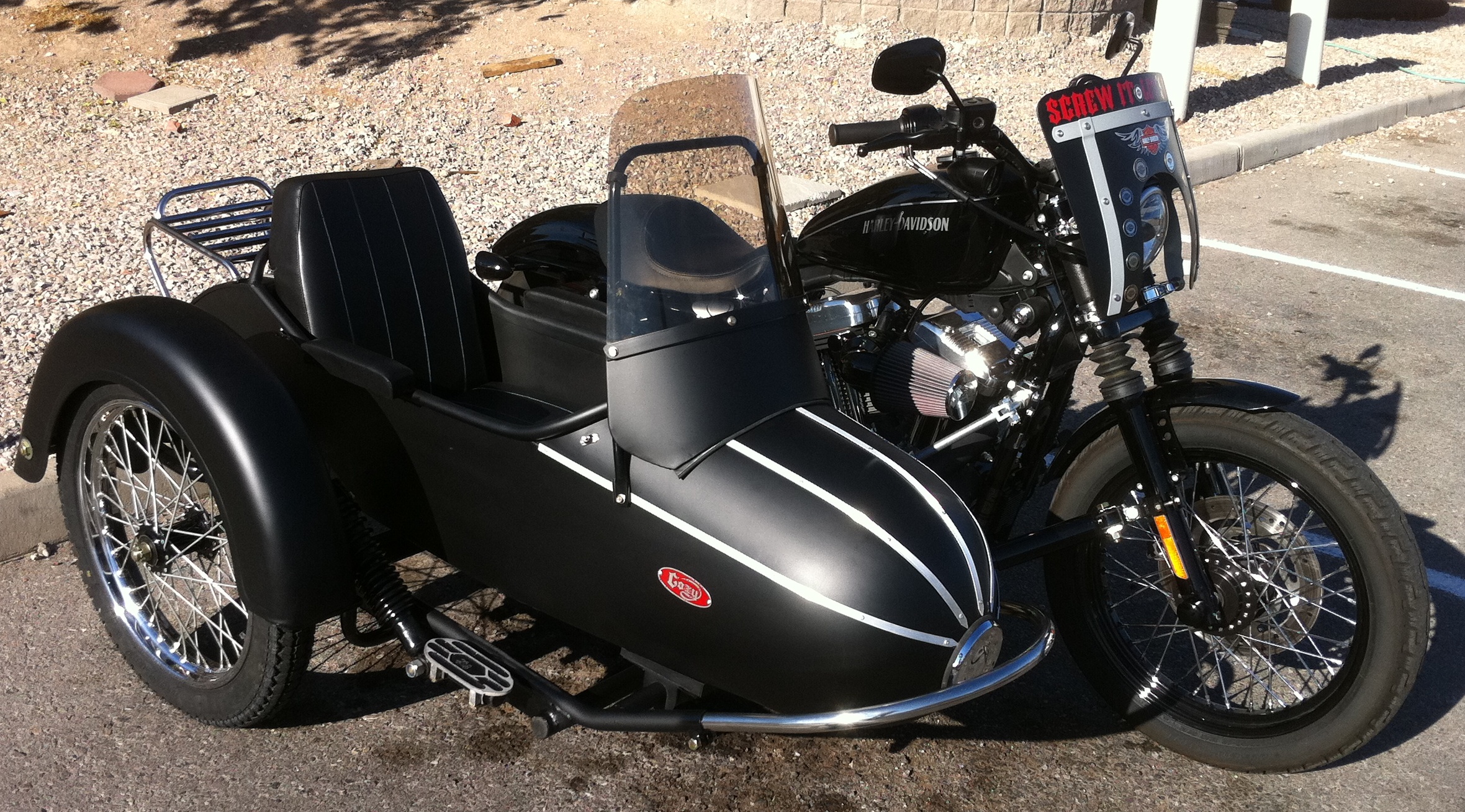

I have rigged my 1200 Nightster to a Cozy Rocket and I just love it! However, I need someone to help me figure out the best way to fix the front fork issue. Since I did the install I noticed the front of my bike has squatted a bit too much. How do I get the lift back in the front end? I have been able to find plenty of lowering kits but so far nothing to give it "lift"

Hey Nighster: I followed Lonnie's advice on my '02 883R and installed a 1-inch spacer on top of the fork springs after I installed the 5* raked trees. Maybe even 1/2 --- 3/4 inch might be sufficient with stock tress; just estimate how much the forks have sagged after installing the sidecar.

Proper sized schedule 80 pvc spacers work well. Not just a "drop in" job since the fork springs are under compression and you will need to compress them further to install the fork cap nuts.

Here is the link to a video that, although is marketing a lowering kit, gives an idea. My '02 had no spacer. You should be able to make a spacer out of 3/4" or 1" PVC conduit, depending on diameter of forks. Some folks use appropriate sized washers to help "spread" the load. There will be more pressure on the spring, so some grunt will be required to push the spacer/spring down to screw on the cap. I suggest a buddy to help to hold all in line while you use both hands to push and turn.

OK, problem solved! I went to lowes and picked up a bunch of different kind of 1" spacers. I ended up using a ½" PVC cap that was just at 1" long. I put my rig on blocks to remove all tension and removed the tube caps. To my surprise, the caps were still under pressure. I put a flat washer on top of the current pre-load spacer then the PVC cap then screwed the cap back on. I will say that was a chore and I was thankful to have my buddy here helping me. After I let the bike back down I regained the lost height from the sidecar weight. Road test.....Seems to handle the same but the bike doesn't dive now when I brake. Thanks again to everyone for the pointers and advice. The whole process only took about 45 min.

Good deal, Nightster. The restored ride height is just a bonus of the extra pre-load. I too was weary of tackling the fork spacers too, but once into it realized it wasn't all that daunting of a task. But it sure is best to have a buddy to help with re-installing the caps.
