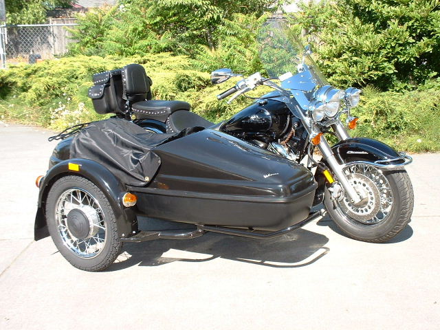

Here's an '02 650 V-Star/Velorex 562 combo. The Cozy mounts the same way and Velorex mounts fit on a Cozy. Nothing too complex here.
