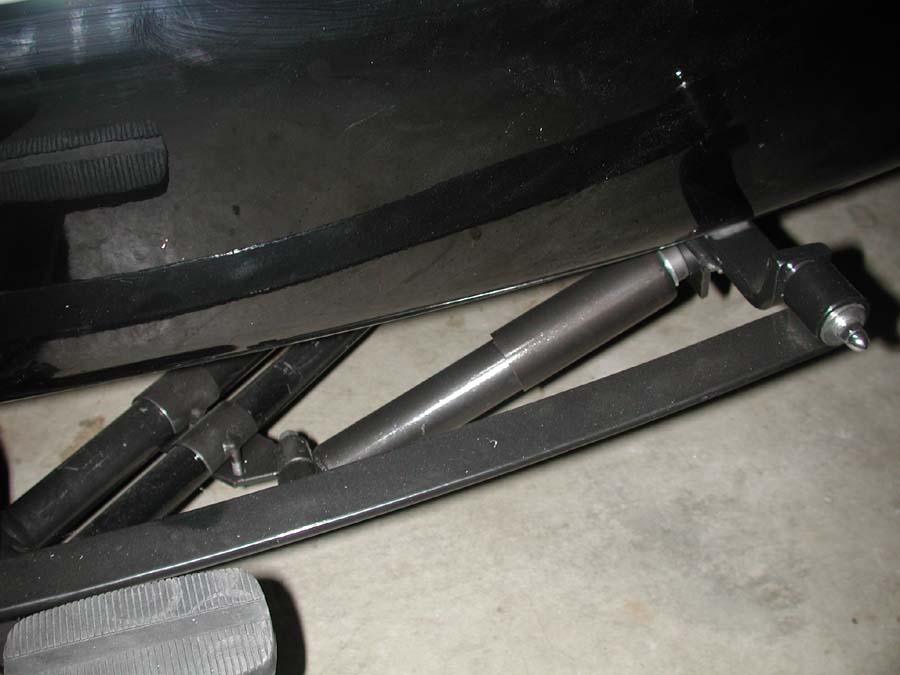

I really don't think that the HD sidecar design needs additional suspension. The width of the HD frame places the wheel out about 53 inches. This means that the HD has one of the widest track setups. This provides for a long moment arm. Thus, when you hit rough road there is very little movement transmitted to the motorcycle. The springs on the sidecar body help out a great deal also.
I noticed that the nose of the tub would have a tendency to move up and down a bit on rough pavement. I solved this problem by adding a car shock between the frame and the underside of the tub at the front body mount. This prevents oscillation and undue movement so the tub rides very flat.

id like to see a picture of that shock mount

Here is a picture of the tub shock. It connects to the lower frame with two U-bolts that tighten up into a bracket. The front threaded part of the shock goes into a hole in a piece of 1-1/2" angle that goes across the three front tub bolts. There are rubber bushings on each end. The shock is a new air shock for a 1969-70 or so Camaro. I built the top cover from a piece of 1=12" steel tubing with a washer welded in to mount it on th threaded shaft.
Enjoy!
