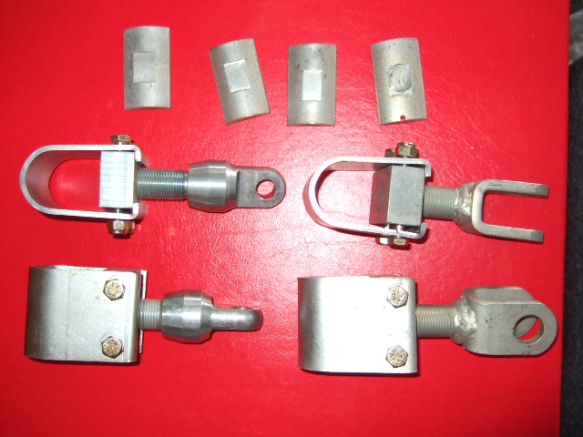

Lonnie, the individual I am getting the Tx sidecar from says he has the mounting brackets for FL touring. I thought he said I may need to purchase one clamp, depnding on my downtoob size (1 3/8"). Thinking about it, if the car is 2006 and my bike is 2009, won't I have to purchase a complete mounting kit for new frame?
Posted : June 15, 2012 7:01 am
The only sidecars that require the Harley mounting kits are the TLE and Ultra Harley cars since the have a unique three point mount system and electrical/electronic interfacing to deal with.
The 2009 and later Harleys have some larger frame tubes than the earlier models.
I have the needed larger size clamp in stock.
Posted : June 15, 2012 9:41 am
I just got done installing an 08 Harley sidecar TLE on my 09 ultra with abs brakes
it takes a kit that cost $1381.00 to fit, the 08 and below sidecars won't fit with out the kit.
The time I got it painted and put a reverse on it I have about $7500 in it, but it now has ABS on all
Three wheels, e mail me and I'll send you a pic, dp2299@ gmail. Com
You can also call Juston @ Fort Thunder HD in Moore Oklahoma, he is in parts,
He can kelp with fitment.
