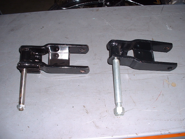

Again, thanks for all the input. This is really helpful to me. But again, where would I measure the diameter of the axle?

If your 562 swingarm looks like the attached wheel and swingarm pic you have the 20mm axle and a wider wheel (still uses the 3.50x16 Mitas sidecar tire).
The 2nd pic shows the early swingarms with OEM 15mm axle on the left and a modified one with a 3/4" Harley axle on the right.
The 3rd pic shows my propriatory heavy duty swingarm kit with 1" axle for heavier bikes, heavy loading and off road usage.
