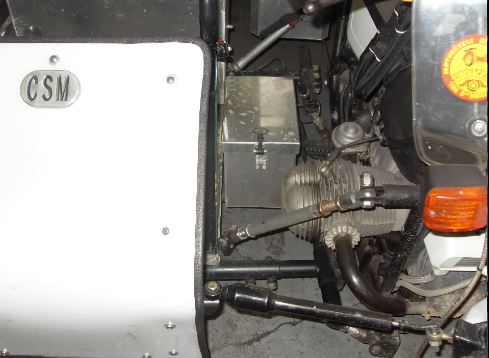

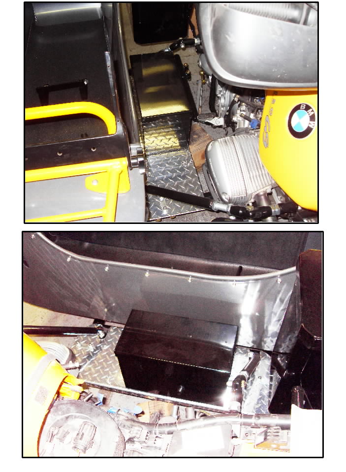

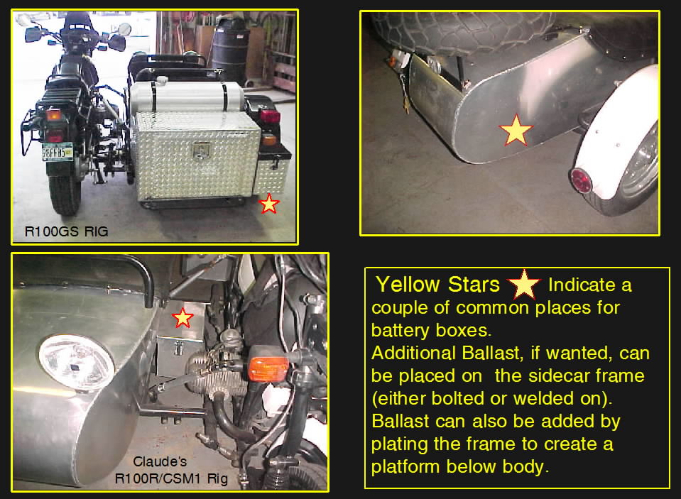

You can have issues if you try and charge a large and small battery at the same time. There should be a disconnect between the two batteries to allow one or the other to be charged by the bike.
Is this worth the trouble? In my opinion, NOT AT ALL. We feel it is best just to convert to the car battery and get rid of th ebike battery all together. We have done these conversions many times and you end up with a battery that will practically last forever, can be quick charged if desired, costs less that a puny cycle battery, can provide ballast if wanted and has enough additional capacity to run some camp lights or whatever. Not a bad idea to plug a battery tender to it when not in use but not really essential.
The exception may be If the bike will be unhooked and ridden solo then keeping the cycle battery in place and using a tender on it may be desired. When converting to solo operation simple re hook up the sysle battery.
To hook up the car battery unhook the cycle battery and just run the new leads to the present battery cables, bolt the new and old leads together and wrap things up in some fashion. Using cables that have eyes on each end and battery terminals that have a wingnut connection (marine stuff) make things simple and provides a nice way to add additional wires to the battery if desired.
You can use one of those inexpensive plastic battery boxes if desired. We typically make our boxes from aluminum and usually do them oversize. The additional space inside allows a nice place to store electrical type 'stuff' and also allows room to add various plug ins etc right on the battery box itself.
Some have added electrical recepticles for camping lights. You can take any trouble light, lamp ot whatever and switch the bulb out for a 12 volt bulb and you're good to go. If you don't want to add a recepticle then simple alligator clips work just fine.
If the battery is mounted inside the sidecar it should be vented well. We usually mount them between the sidecar and bike. See attached photos.
Posted : November 20, 2009 1:05 am
