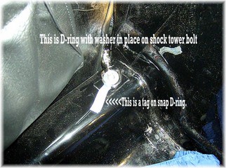

There are probably a million ways to make a harness set up for a hack dog. Here is just one and a few of my thoughts on it.
1. I agree that a harness is the best option, as the g-force in a wreck is gonna' put a lot of forceful stress on a dog's neck for sure. However, to assume any tether device/anchoring device or dog securing device will actually do much in a wreck is pure speculation, at best. It all depends on the nature of the wreck, itself. It is probably more of a "Feel Good" modification than anything else, but it serves a few different or useful functions; it works to keep the dog in the hack when you are parked, it gives the dog knowledge of just how far he/she can go and how much freedom of movement he/she actually has, and it works well in training the dog for hack riding in general. In an actual wreck, all bets are off though. Again, too many variables to speculate on and it depends upon the nature of the wreck.

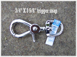

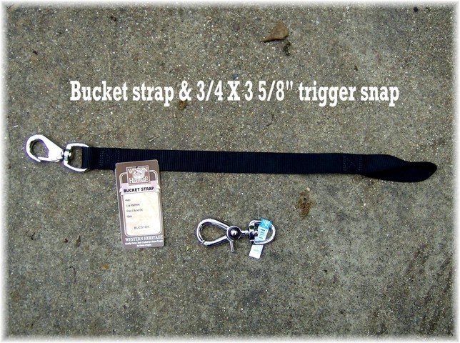

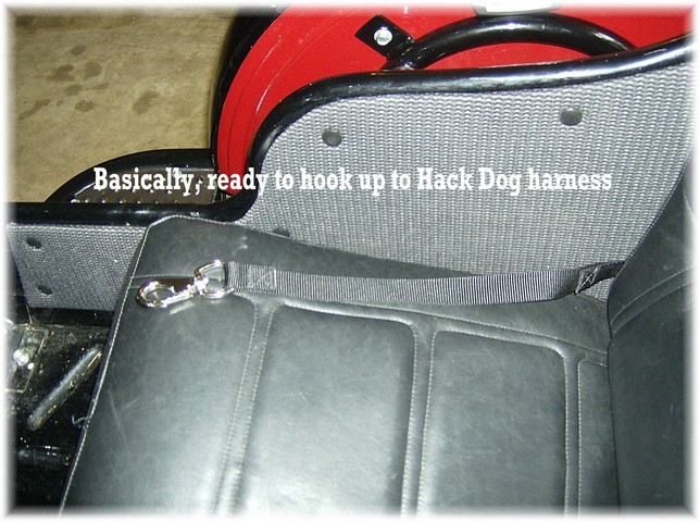

2. I went to Tractor Supply Company (TSC) and went to the horse section to find what I needed to make a good working teather for my hack dogs. I found a bucket strap and a trigger snap to make up my teather device. The bucket strap came in various sizes, but I believe this one was maybe 18-22" in length. The bucket strap has a snap hook on the one end and a loop sewn onto the opposite end. I simply put on the trigger snap backwards at the loop and routed the bucket strap between the side of the hack and the side of the hack seat. The end of the trigger snap had a D-ring on it. I placed it onto my shock tower, but I could have anchored it to the trunk bed just as easily. If your rig isn't set up with shocks like my Ural Troyka, then I'd suggest bolting through the floor and use of some good sized fender washers and stong bolts. I then placed a larger-sized washer over the D-ring and then used a nylock nut to cinch it all down into place. The g-force of the tether strap is straight forward when the device is stretched or pulled outward. I also put in a second bucket strap on the opposite side, as I generally ride with two dogs. I also have a standard large dog leash that is also just looped about the seatback, so I can actually ride with all three of my dogs when I want. It is anchored to the back of the seat and simply loops about the seat in the front. As I said, there is likely a million ways to install a teather and then anchor it to the hack in some manner, but this was what I did and it has worked well for me. The bucket strap does not have too much length so that the dogs try to bolt.
3. I have never had the dogs attempt to go over the door exit in the hack, so I don't agree that any mesh, net or door needs to be included as a precaution. A good sized dog could easily hop right over anything that obstructed his way in the first place. The size of the strap works as a deterant in keeping him/her inside the hack.
4. Here are some photos and I hope they show what I am talking about in making a device to hold the dogs securely. It is very easy to hook them up and to unhook them as well. This is maybe more work to manufacture than you would like to put out, but it seemed simple to me and was worth the effort. After about 2 years of daily use, I have no problems to report. My Bichon will run out and sit in the hack in my garage for quite a while in waiting for me to come hook him up and ride. He is a hoot. He learned how to climb in on his own. I don't allow any of the pooches to dismount on their own though. My step plate is just too high. My Lasa Poo did that once and fell directly onto her shoulder. She yelped and cried as if she had broken something and it was very upsetting to me. Luckily she wasn't hurt badly, but I don't allow any of the pooches to get out on their own after that. That first step is a killer when they are exicted.

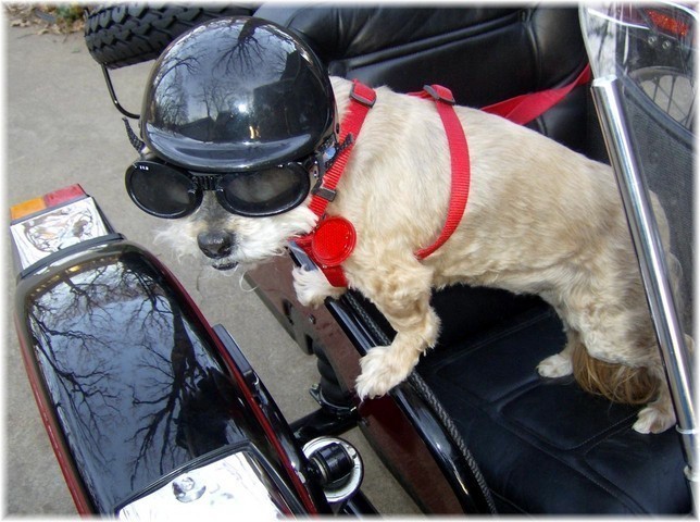

Here is a small photo of the mesh goggles offered at Doggles. Like say, they may or may not work better than the standard Doggles. I am ordering a pair to see if the dogs like them or not. Reasonable price on them.
Here are the girls, Baby and Bosco. I couldn't find a pic of all three of them, but they all find their place when riding.
