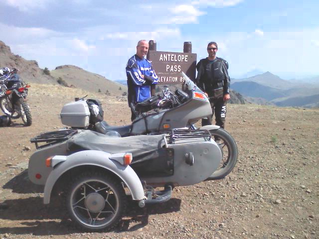

Sluggo-
I just finished mounting a Dnepr car to my '98 V11EV this past summer. I ended up using a 17" cast rear wheel from an early '80's Suzuki GS1000. Same axle diameter as the Dnepr and all clearances worked. Mounted a Dunlop D404 on it and it works great. Removed the disc and have not found a need for a sidecar brake, although some like them.
Good luck with it!
