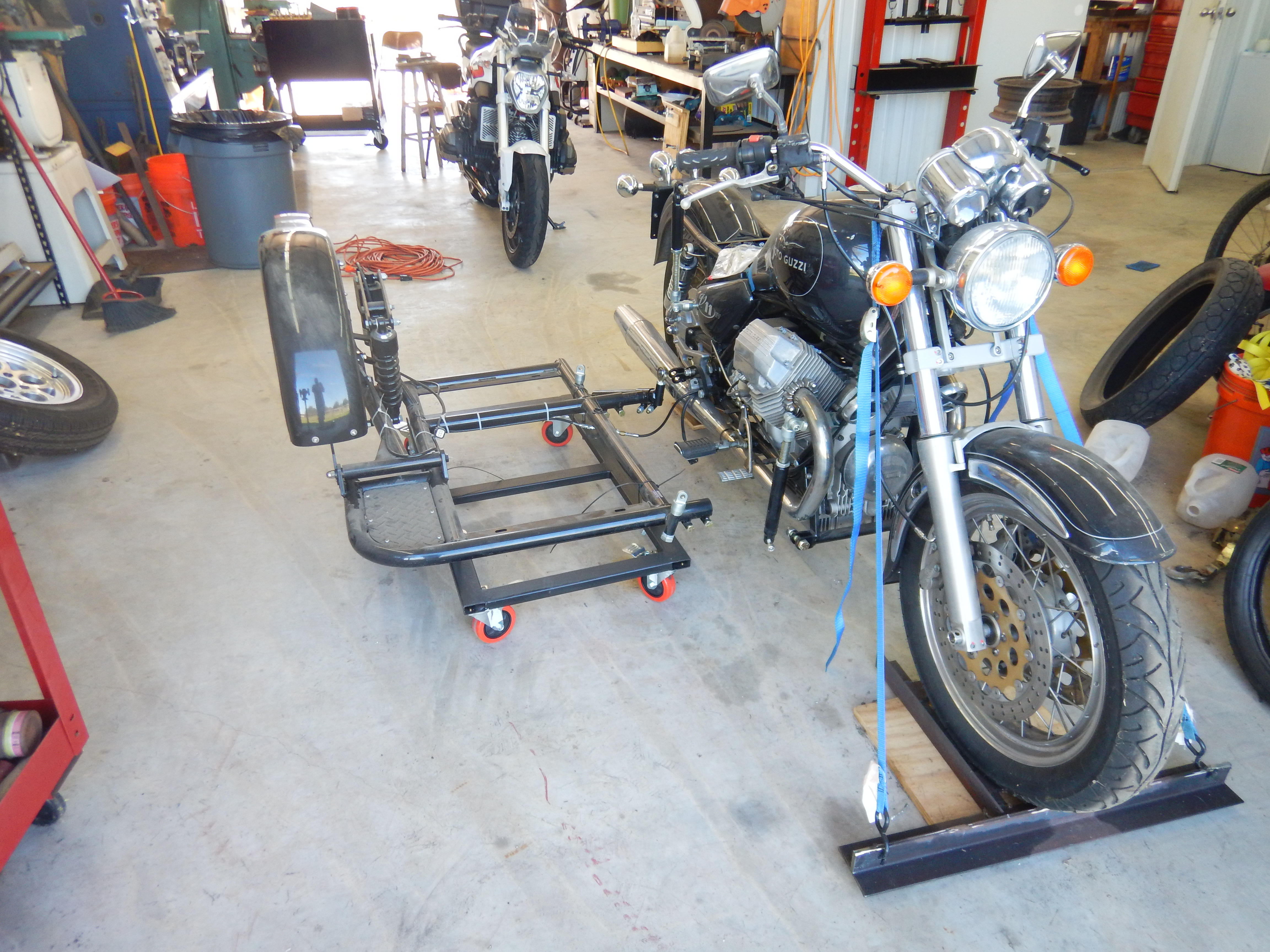

Installing a DMC sidecar on a 1998 Moto Guzzi V11 (California). Several items have been changed/upgrades prior to this post. I'm at the point where another pair of eyes is recommended.
Changes made to date:
1. Final drive exchanged for lower gearing
2. Ignition moved to battery compartment
3. DMC triple tree (easier steering)
4. Lower, wider bars
5. New brake lines (bar change and sidecar brake addition made this a good idea)
I stole Jay's idea and built a cart for holding the hack when fitting. Life is good. 🙂

Tried using a furniture dolly and scissor jacks. I prefer the dolly, more stable. The casters were the expensive part.

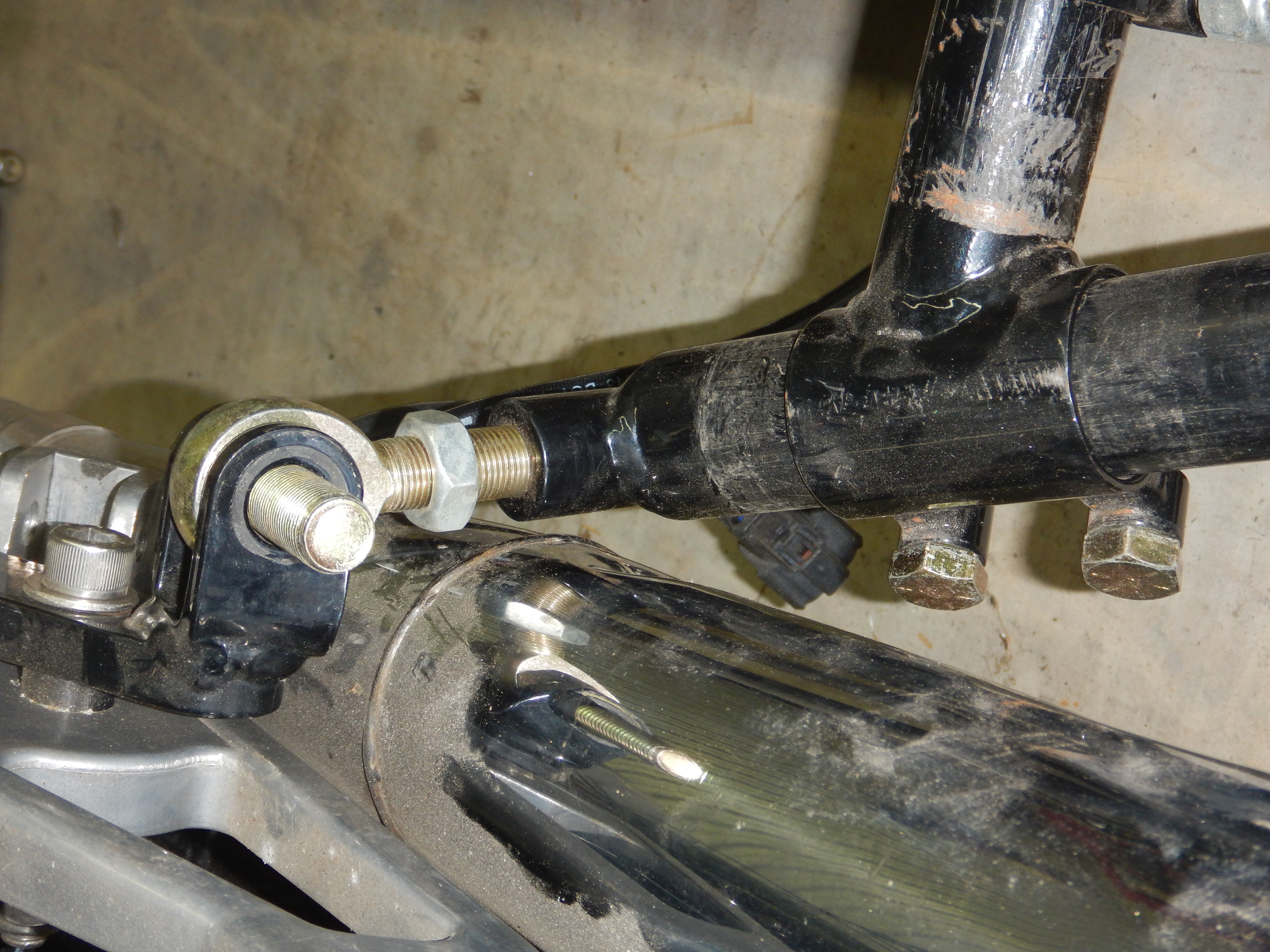

Hey Jay, just the man to ask. Meant to post the question yesterday but got sidetracked.
My problem is the heim joint engagement in the rear mount. By my measurements only 3/8" engagement is possible with "proper" alignment. See pictures below.
The bike is squared up. The hack frame is squared up on the dolly. I do understand the wheel needs to be on for the alignment but wanted to sort out everything first. I also understand final adjustments should be made with the suspension normally loaded.
This is a bit frustrating as the images can only be added (to the best of my knowledge) after the text is posted. Please have a look at the attached photos and see if you can see where I am going wrong.
Posted : February 17, 2017 9:27 am

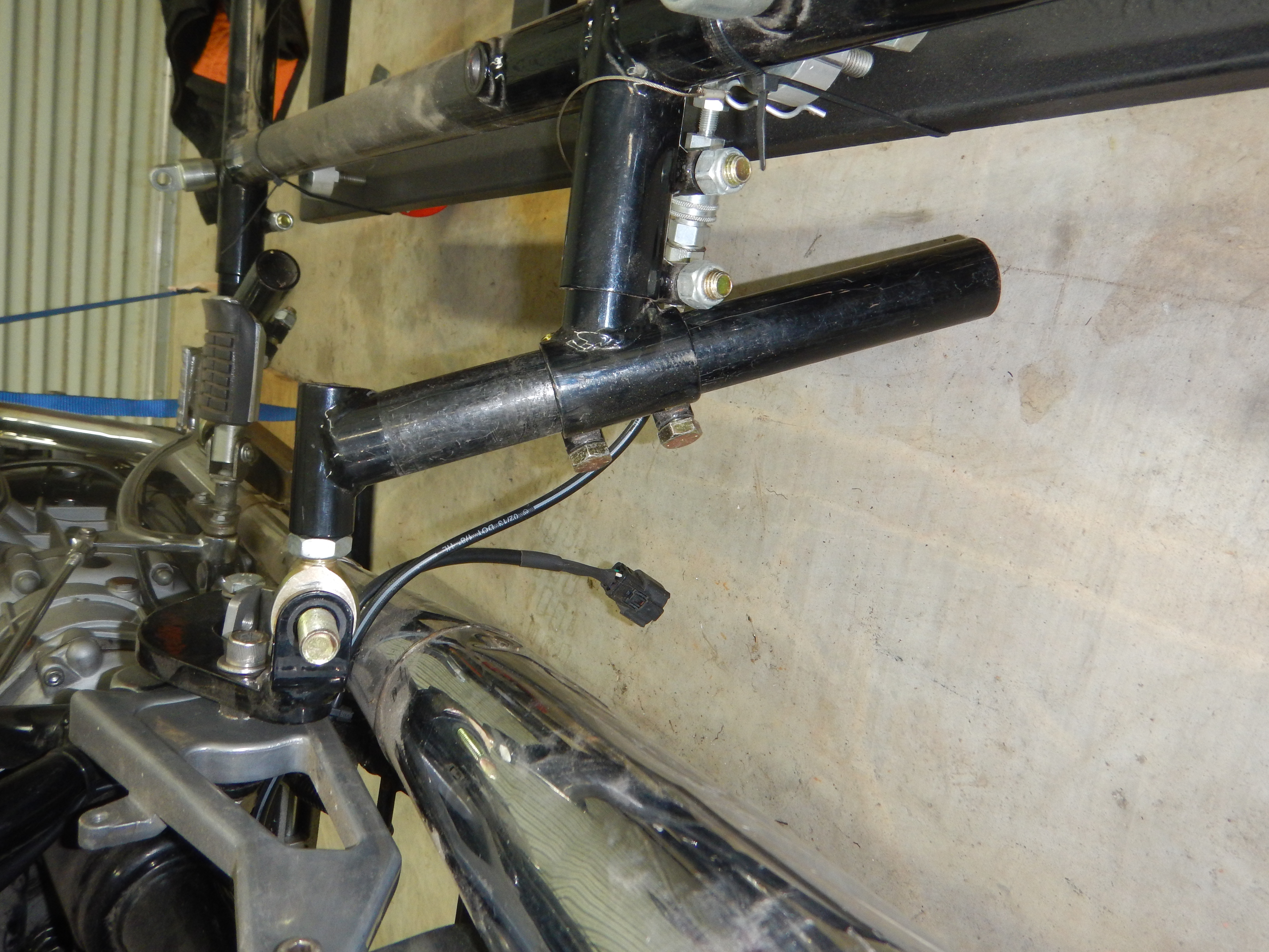

(@rtbain)
Posts: 13
Another view of the rear mount.
Posted : February 17, 2017 9:33 am
Normally the joints go straight on parallel to the ground. Try rotating the clamp. You may have to cut some off of the boss so that it does not hit the ground. We do make bosses with longer ends for the hiem joint if need be.
Posted : February 17, 2017 9:34 am

The front mount is parallel with the ground.

(@rtbain)
Posts: 13
I have seen the videos. They are well made and clear. Unfortunately I can be an idiot at times. Finally figured out the correct orientation thanks to your kind guidance. Photo below.
