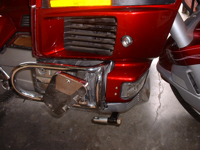

i dont think the hardpoints for mounting will present TOO much of an issue for my style of riding. looks like id have to get it pretty far over to cause any interference...
