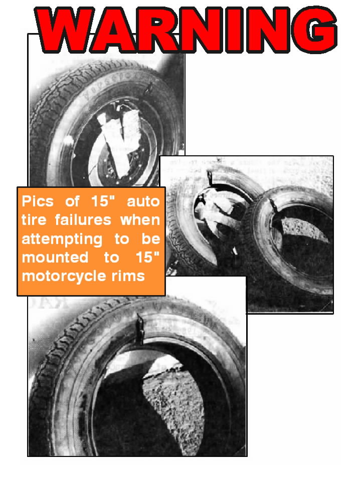

15" can be an issue. This has been beat to death on this forum. The 15" cycle rims are larger in diameter than they coudl be for the 15" car tires. Other diameters seem to do okay but 15" is the bad apple. Some have mounted them and some have had troubles. It is not recomended by most who have been aroudn for years. If you do decide to go forward with it do not use extreme pressure to seat the bead. See attached pictures.

Wes, yes, the failures in the pictures did take place during mounting.They were provided by Hal Kendall in an article years ago. This 15" car tire / Motorcycle wheel debate is nothing new.
You will hear some say something like " What's the big deal I did it and have run a buh zillion miles with no trouble" You will hear others advise against it. You will even hear others debate that cycle wheels, no matter the diameter, are not designed for automotive tires.
Sidecarists, almost all of us anyhow, are using a bike for a purpose it was not specifically designed for. Through the years many things have been tried and time proven to work well and be safe. Also through the years some things have been tried with iffy results. Experience has left it's marks some good and some not so good. Mounting car tires on 15" motorcyle wheels has enough 'iffyness' to it that most who have played with sidecars through many years will advise against it.
Again, it is your decision and your responsibility to deal with the outcome.
Posted : June 18, 2009 6:42 am
