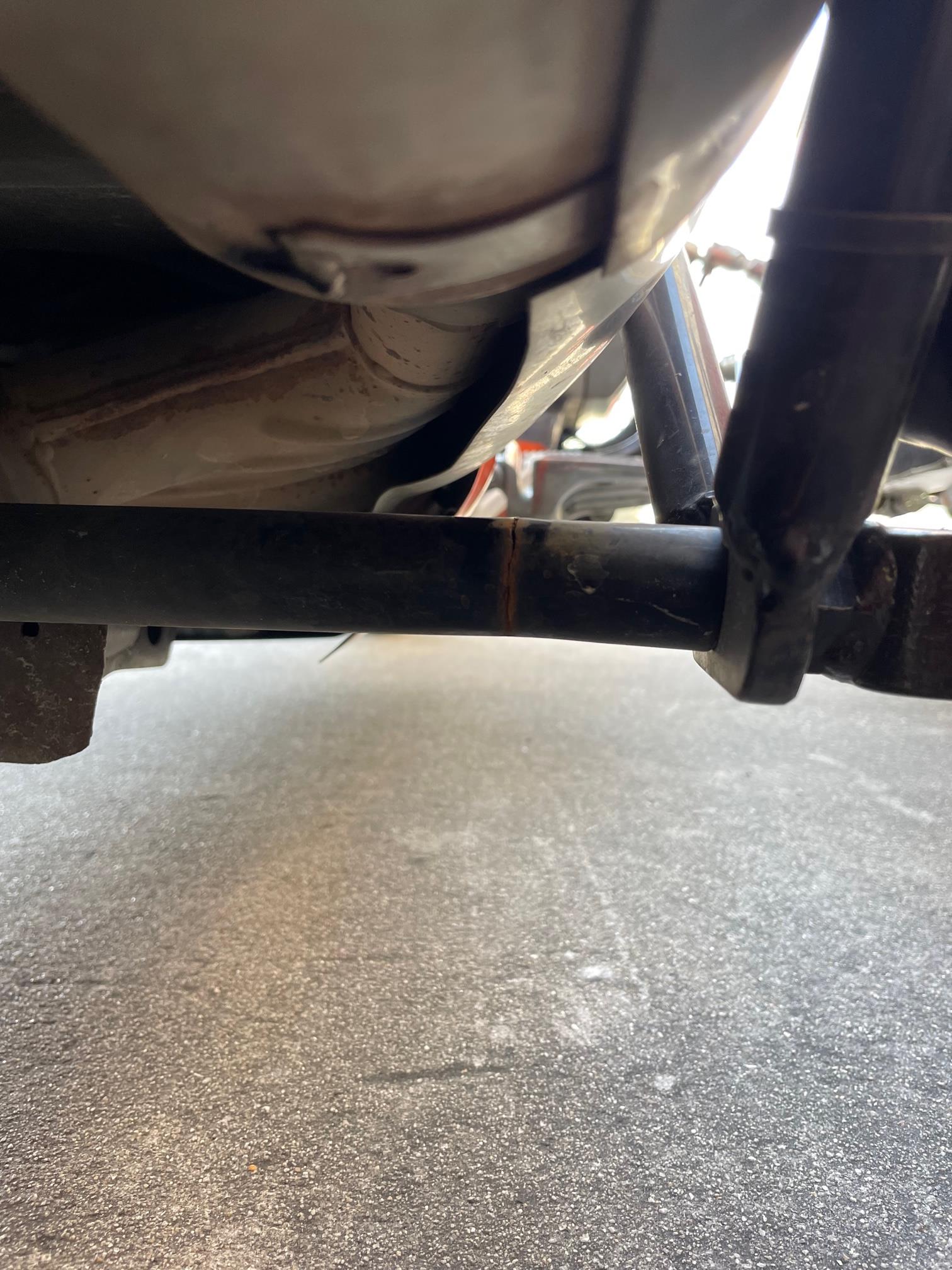

So I noticed a weird banging noise the other day, got home and found the bolt to the lift cylinder had come out, I replaced it and all seemed good again. Well on my way to work this morning I notice this faint clanking noise again, but this time much quieter, I get to work and standing behind the rig it just didn't look right, the bike appeared to be leaning toward the car and the tire on the car appeared to be leaning, So get out a square to see if was just my imagination and when I slid under the back to find a good spot to check it I found this,  So I will have to nurse it home and remove that part of the sub-frame so I can repair it. I'm a good welder and can fabricate but any thoughts on the best way to repair this are welcome. It appears to have broke right at the end of the inserted threads for the yoke. Also any thoughts as to why it would have broke there.

Probably stating the obvious but if you insert a smaller tube and sleeve it when you do the repair that would add strength.

Ace, that is very similar to the break my sidecar frame had in Alaska, after hitting a few potholes a little too fast. The welder in Fairbanks leveled that strut, then cut a 6" piece of pipe lengthwise. He laid one half on top covering the break, and welded it in place.  The other half piece he welded to the bottom. His $125 repair was strong enough to let me ride the 4000 miles back home to Texas.
Back home, the professional welder said the Alaska patch was strong and not to mess with it.  We removed the tub and found two more cracks in the sidecar frame.
Lesson learned: If you have one frame crack, carefully check for others

You can bet I'll be inspecting it very carefully once I get it home and start taking it apart to repair it.
