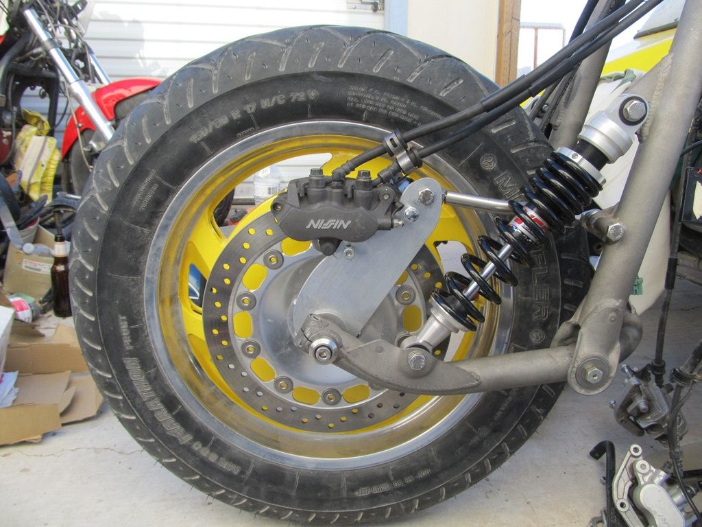

Here is the current project that led me to the cracked axle:
Re-designing the caliper mounts is a pain - that pattern took me all friggen day... with a hacksaw, a belt sander, and a drill press. Kinda irritating: I mailed the calipers to WASP, and then they shipped them back with the Leading Links themselves. Somehow, the caliper mount holes are short by about 8MM, meaning they used a rotor diameter 16mm less than stock... ??? They also designed them so the hoses face forward... Sigh.
Dropping these off at a machinist tomorrow to make a bearing pocket out of 6061 and then weld onto a 6061x1/2" caliper mount the water jet guys are doin tomorrow.
