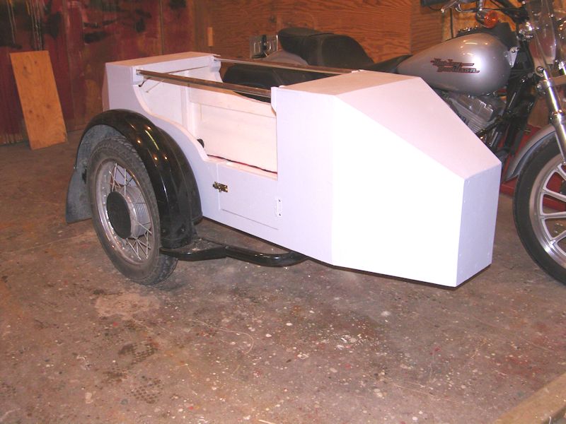

I just put a Velorex 700 on my Harley FXD but the body wasn't suitable for my 100 pound Bloodhound so I built my own wooden body for it suited to the dog and cargo. It will also seat a passenger (if they aren't too wide LOL!)
