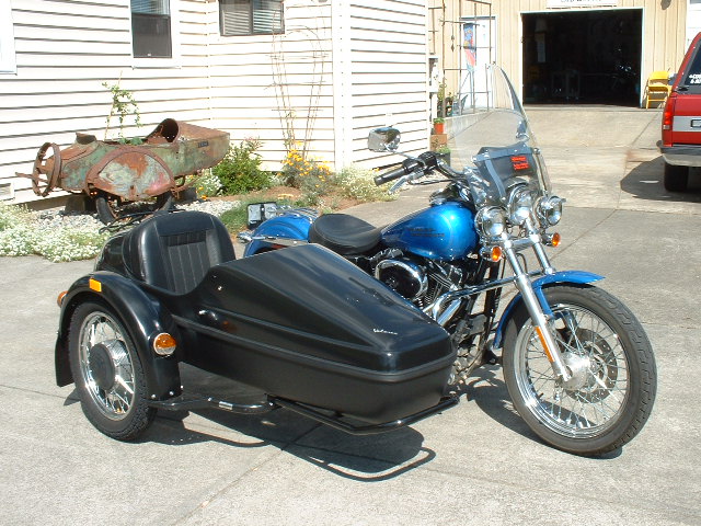

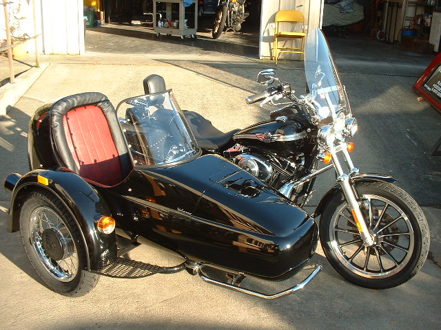

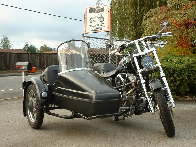

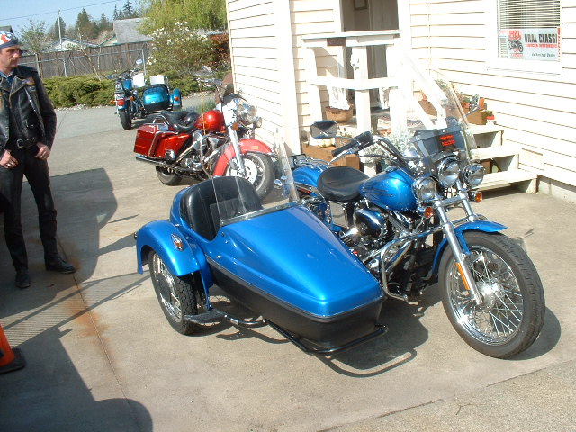

I've done several FXD's for customers and myself.
My last FXDL was an '03 Anniversary model with a 563 Tour Velorex (the rig in my avatar photo). It just got totaled last week and I've just finished mounting another 563 Tour on the replacement bike. A 2008 105th Anniversary FXDL. The '08 has a different frame than the '03 so it took a little magic to mount the car. I'll road test it tomorrow.
Here's a couple of FXD's setups from my shop. They make great tugs.
