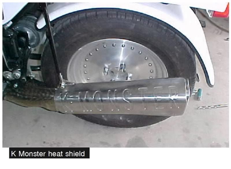

I don't believe that tire would fit a cycle - too wide. Claude Stanley builds an adapter that lets you fit a Centerline brand dragster wheel to a K-bike rear drive. That is what he did for my K-Monster. It takes a 145 width tire. Much less expensive than a whole custom-built wheel.

We have well over thirty of these types of conversions out there at this time. The most commonly run tire is a 165/80x15. (165r15). Feedback says average milage with this tire is around 20,000 before replacement.Not bad for a tire that runs around 60 bucks or so. Worst case heard of was 16k which was on a k1200lt/ Hannigan pulling alarge trailer much of the time in the hot south west.
To keep costs down we have not used the centerline wheel like Sarge mentioned for a while now. It is an option though.
