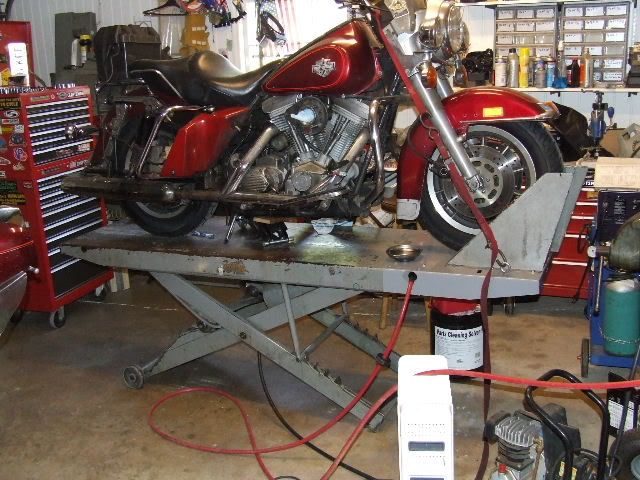

This is my friends on the rack with out the sidecar to do some work. Notice the batter box on the luggage rack. When the sidecar is attached he has the battery in the sidecar. This bike has over 200K on it.
