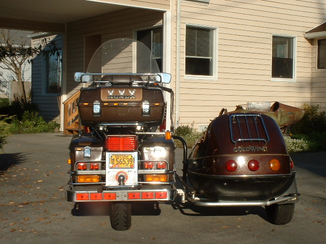

Here's a couple of early FSI taillight pix.
The lenses used to be available at truck stops.

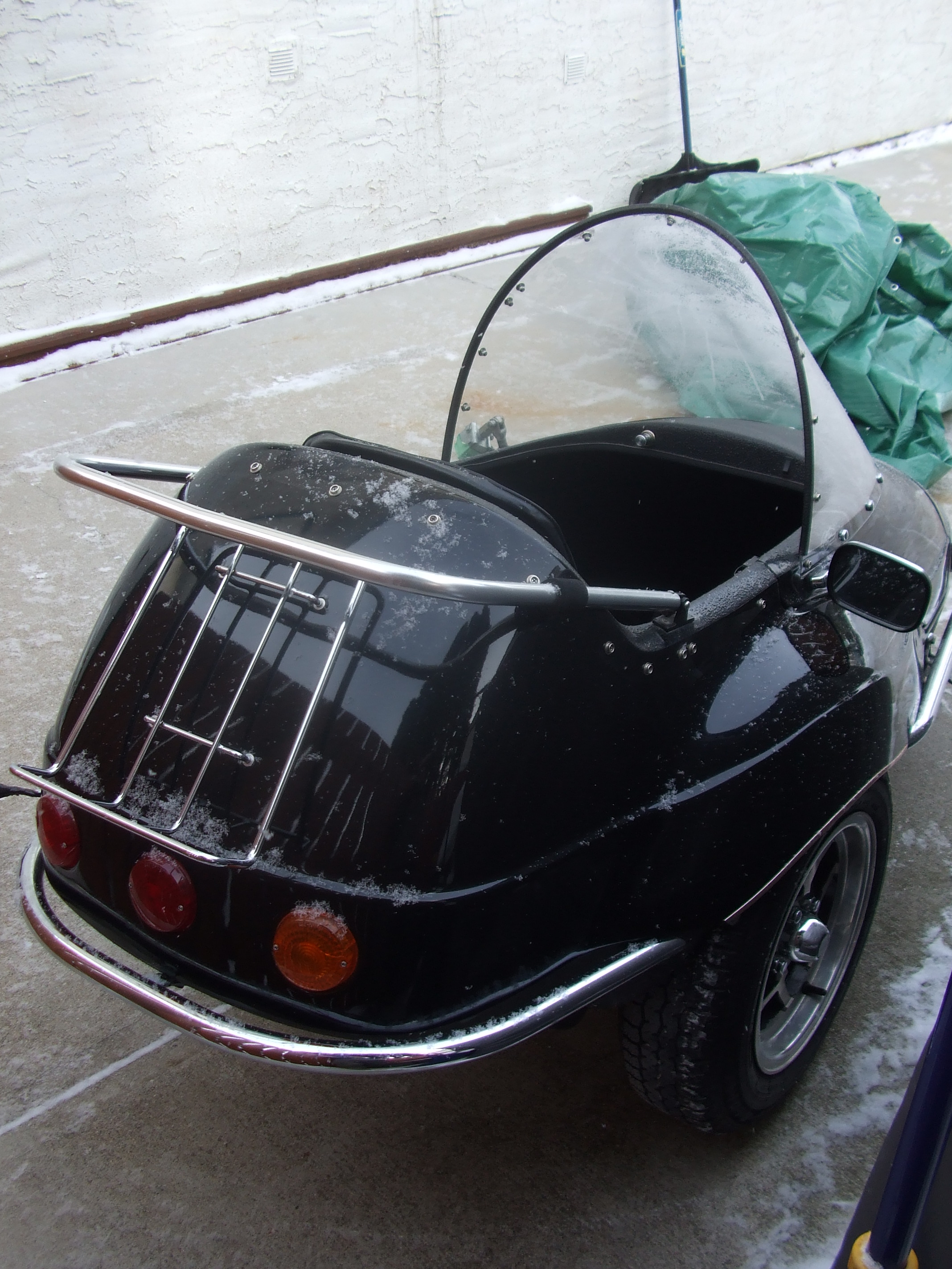

My Friendship II I just bought.
Posted : January 21, 2011 3:51 pm
Hack'n - 1/21/2011 8:35 PM Here's a couple of early FSI taillight pix. The lenses used to be available at truck stops.
Thanks Lonnie. I never was able to find replacements for Jennifer's lenses. We finally enlarged the holes and used different lights all together.
Anyone out there have a photo of a Formula 2SE or 3 with the short taillight?

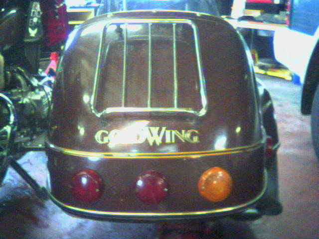

Slowly but surely, the marraige is taking shape
Of course, I'm about ready for a test drive, so we have a major winter event taking place outside. Oh well, I'll just have to clear the driveway before we go.
