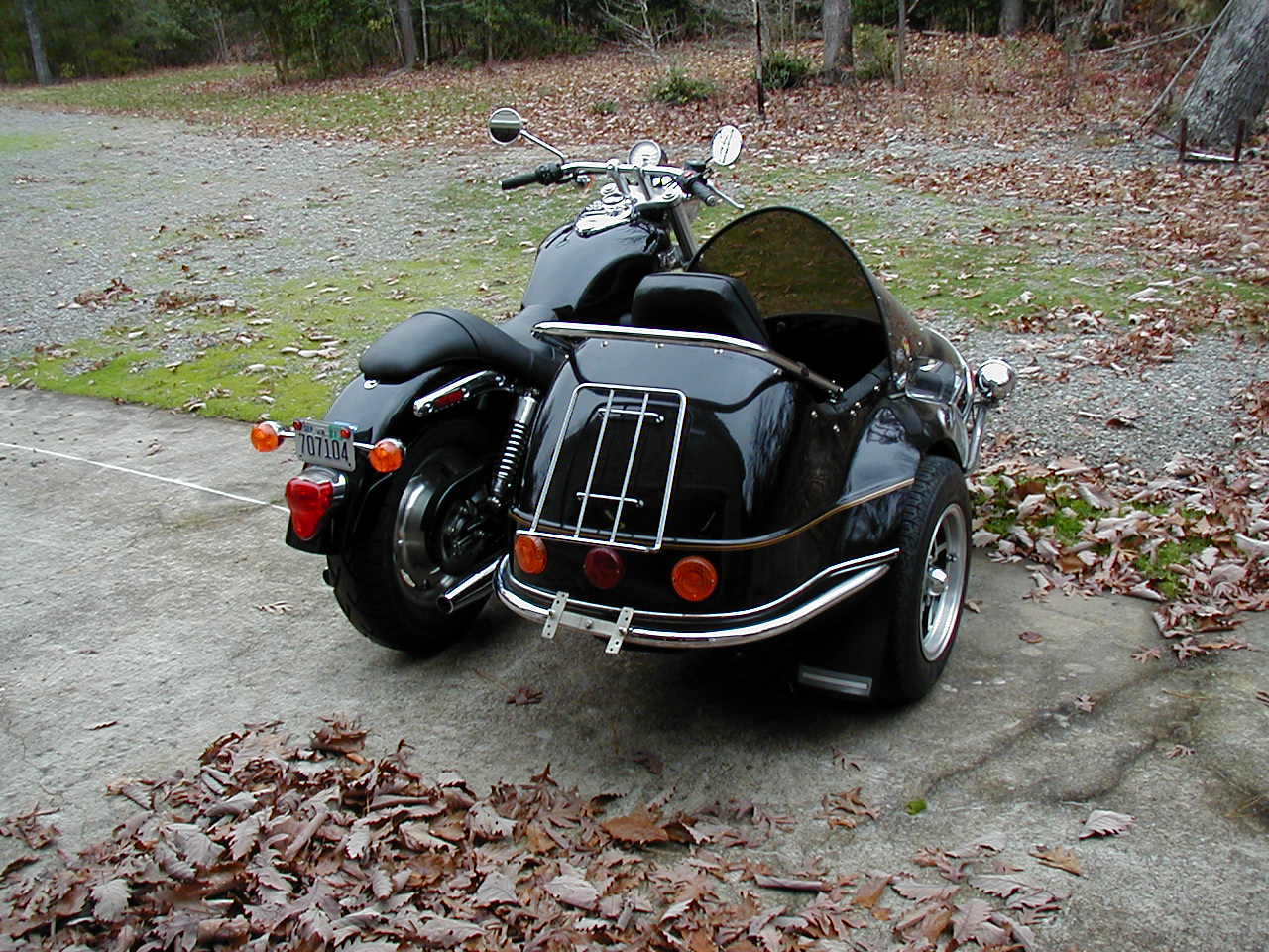

Looking at all the posts on California Side Cars, I am wondering what model I REALLY have. When I bought it on ebay, it was described as a Friendship II. I must admit at the time I knew nothing about side cars. Now I see all these variations and am confused. The only indication on the hack is a stamp on the windshield that says "California Side Car". My hack does NOT have a brake nor does it have a lean function. As mentioned in an earlier post on wiring color codes, there is no color code at all, all the wires are yellow and I can tell that somebody has been messing with the wiring as some of it is a mess. Any body have any ideas what I have?
Posted : January 26, 2012 3:19 am
Boatzo - 1/26/2012 8:19 AM Looking at all the posts on California Side Cars, I am wondering what model I REALLY have. When I bought it on ebay, it was described as a Friendship II. I must admit at the time I knew nothing about side cars. Now I see all these variations and am confused. The only indication on the hack is a stamp on the windshield that says "California Side Car". My hack does NOT have a brake nor does it have a lean function. As mentioned in an earlier post on wiring color codes, there is no color code at all, all the wires are yellow and I can tell that somebody has been messing with the wiring as some of it is a mess. Any body have any ideas what I have?
It appears to be a Friendship 2. The brake and lean function were both accessory add-ons when it was purchased. Both can be added later, but it can be difficult to find the necessary parts as the company stopped sidecars altogether.
The original Friendship did not have the front opening like yours does and it only had 2 taillights. BTW, guard them with your life. Although they look like a common trailer lens, no one has been able to come up with an exact replacement for them.
Posted : January 26, 2012 3:34 am
Your sidecar is an early freindship 2, latter ones California sidecars apears to have used a Champion Escort as a starting point to make changes which is why latter Freindship 2 sidecars open different. Your sidecar may also be early enough that it has a torrsion bar suspension rather then a shock / spring if this is the case then you can not up date to electric trim with out lots of changes to the sidecar and frame. Brakes can be added.
