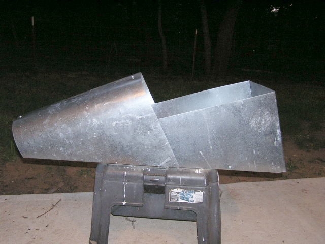

I spent a couple of hours this afternoon and I have a 1/2 size prototype of a sidecar body put together. Full size will be 24" wide and 6' 8" long. It only takes three pieces of sheetmetal. The body will have a frame of 1/2" or 3/4" square tubing. The sheetmetal will be either pop rivited or brazed to the body subframe. The main frame will be made of 1 1/2" square A36 .125” wall thickness. I need to find out if the guy that does the powder coat can do hot rolled steel otherwise I will have to use cold rolled (more expensive). I will have a rounded corner at the back with a 6" radius instead of being square. It will look better. I may use the passenger seat out of my old Ford Ranger. It is only 20" wide and has an adjustable back.
I will use either galvanized or aluminum sheetmetal.

Sandblasting an A36 steel frame may be thriftier than using a more expensive material.
I use .120" wall square tube stock for most of my fabricating. No tubing bender required and no excess shaping for a tight fitting weldment.
This stock has no mill scale and will also powdercoat well.

I forgot the .1 in front of the 250. I think 1/4 would be too hard to work with. Will edit the thread.
