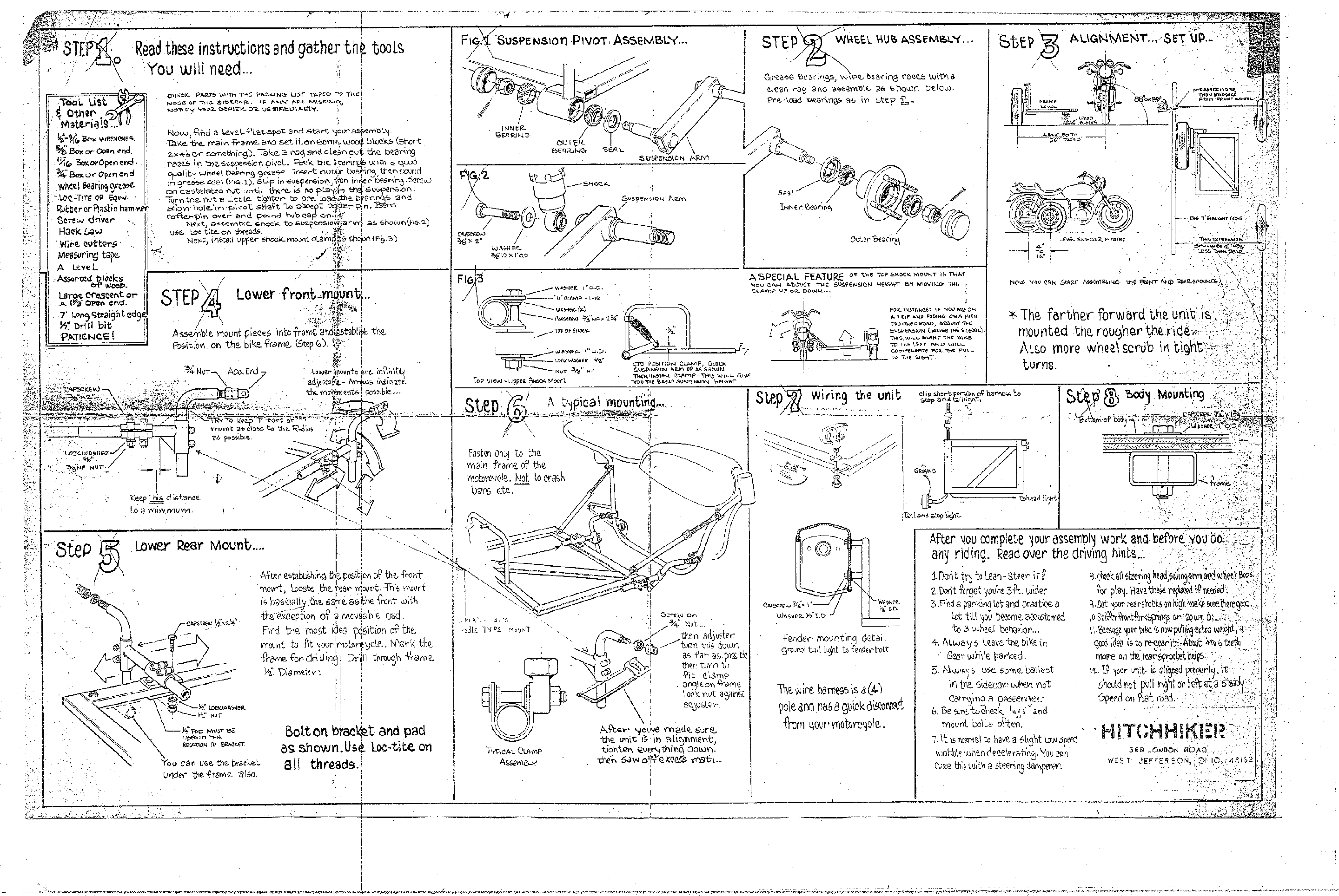

Been thinking of buiding a sidecar for my 82 honda cm450c,
started today to look for information on the web.
found this site right of the bat, seen a lot of good pictures to get ideas from,one thing i could not get is a clear understanding of, is how the wheel & axel are mounted on the sidecar frame.

Most are attached with a trailing link swing-arm suspension system using a cycle type coil over shock absorber.

Thanks hack,i looked at the site,got a lot of good info. but i am still looking for a good picture of the trail arm of the side car,if i ever see a picture of something,i can figure out how to make it. tks trieste

This might help give you some ideas.
Make sure to view it at full size otherwise its hard to read.
