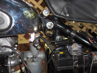

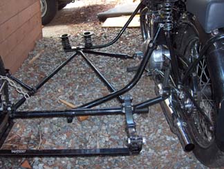

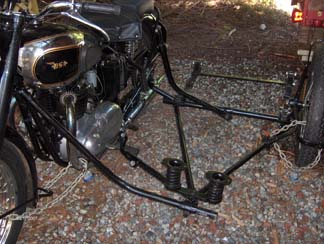

The problem I have is where do 2 supports go. One is from the front of the frame and ends at the front chain and clutch housing and the other is from the center of the frame and ends up at the seat spring. I have also included a picture of the tapered boss under the front of the seat. I would have expected that would be where the rear brace would go.
The front brace which is now attached goes to a tapered boss under the steering head and the rear attachment threaded into a boss in the rear hub.
Any help sorting this out would be greatly appreciated.

In this instance the remaining position for the rear upper strut is at the seat post mount, the front strut would be connected as near as possible to the steering head, probably on the downtube.
