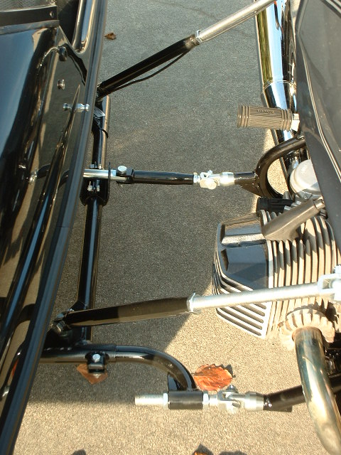

Bill,
Change your lower rear mount from the 90 degree position you now have it to the method in the attached pic. Less chance for slippage with a straight push pull mounting. Above or below the sidecar frame tube, whichever makes it the most level. Lonnie
Posted : May 6, 2010 3:46 pm
I'm waiting on the rear subframe piece, and then Ill know where that lower piece attaches to the bike. Thanks for the advice and photo.
Posted : May 6, 2010 4:14 pm
Move the curved piece tpward the bike. I have an 83 R100RT with a 562 mounted and will send you a pix of the set up if you like.
