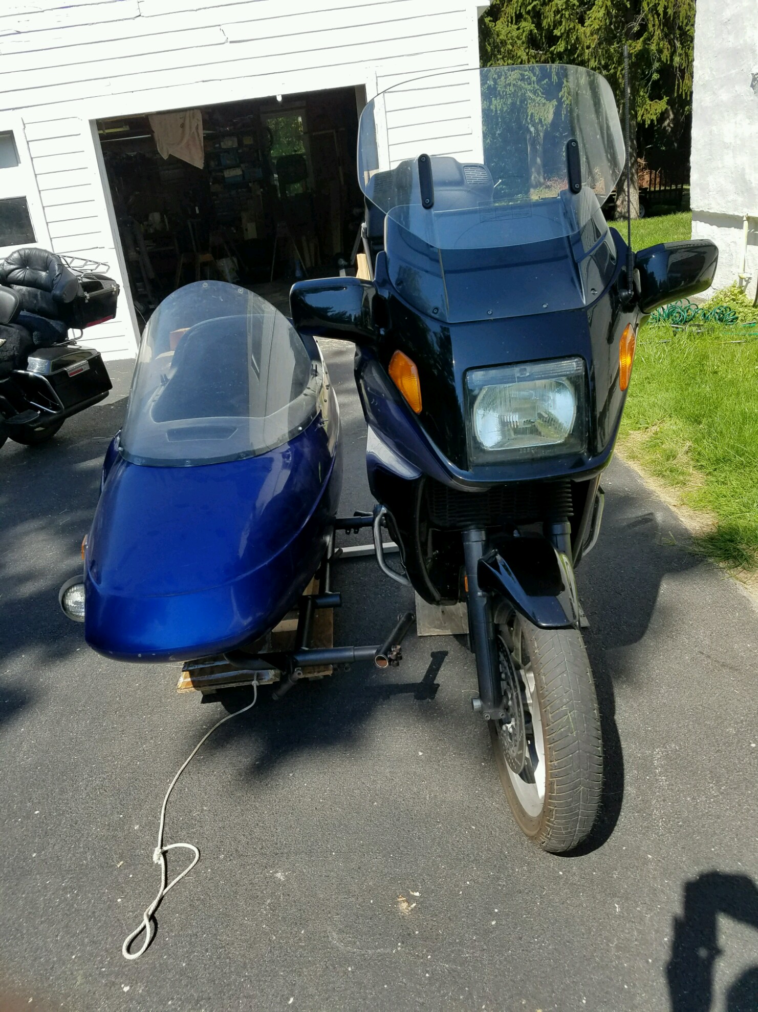

Just picked up a 1997 K1100 .
Want to attach a friendship sidecar .
The sidecar was on a gold wing so it looks like it has an extended frame ?
Which looks to long for the Bmw .
Does anyone have a picture of a friendship sidecar frame that is not extended ?

Within the last week or so there was a person on here who had the flip side of your problem. He has a short frame and needs a long one. Do a little digging and you might find a perfect solution.

The long frame can be made to work, you may need different bosses and clamps which along with your sub frame we do offer.
