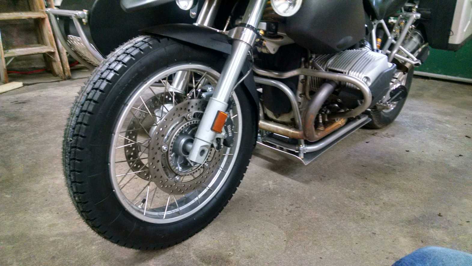

Posts: 616
You don't say what year GS, but based on the 110 tire size I'm assuming it's a 2005-13 pre-waterboxer.
If you want to go a little different route, try a 130/80-17 mounted on a front wheel from a R1200RT or something similar. Although it's a 17, not a 19, it's an inch wider so you can mount a wider tire. The 130/80-17 is about the same overall diameter as the 110/80-19, so your ride height won't change. Make sure you get a front rim from a bike that takes the same rotor and ABS ring as your bike. Use the Max BMW fiche to do your research.
Here's a pic of mine--
By the way, a 140/80-17 will actually fit on that RT rim, but will NOT fit under the fender and, ifyou delete the fender a 140 still might rub the forks. Stick to the 130 and you'll be very happy!
