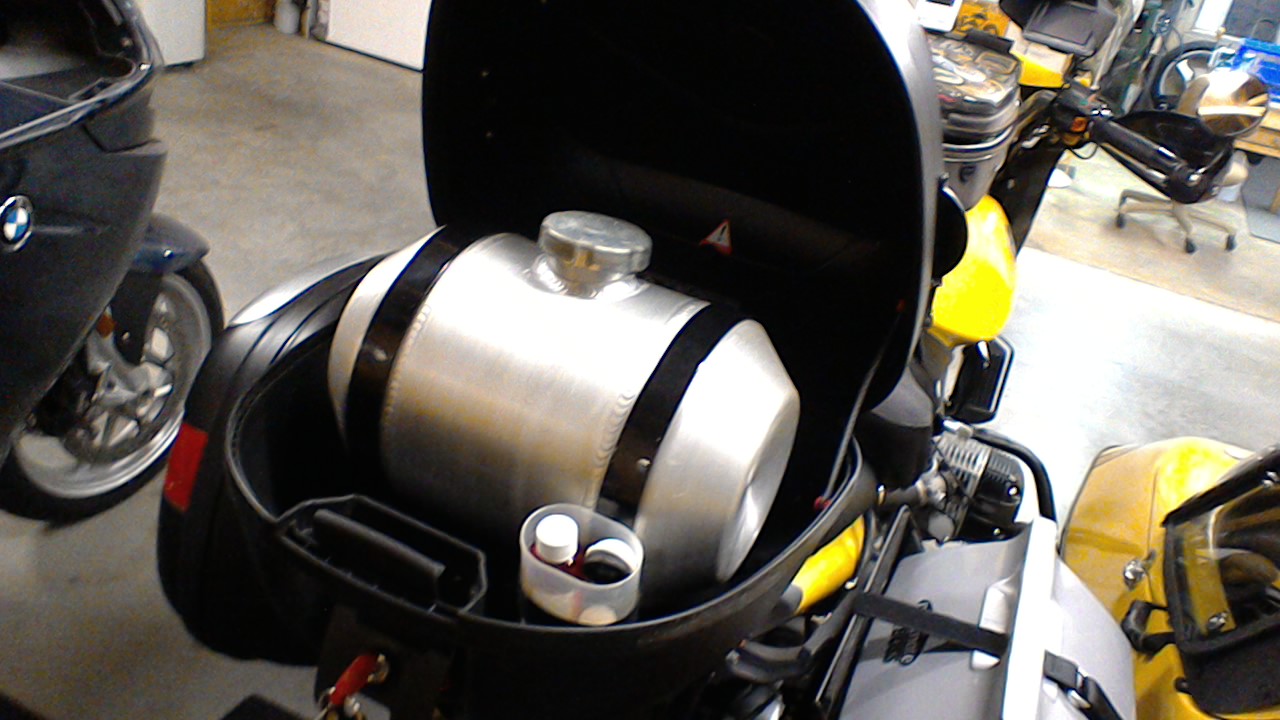

I live in Martinsville, VA on the southside, due north of Greensboro, NC about 45 mi, 13 mi from NC line. How bout you? I have the tank mounted in a tail trunk hooked to a fuel pump teed into return injection line with a check valve so as not to pressurize the aux tank. I can transfer 2.2 gallons in about 5-6 min while traveling.
